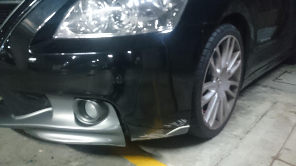

I have a Toyota Aurion TRD 2007.
Had a small accident today (a dog ran out onto the road, car was behind me so stopping not an option. Decide to swerve toward footpath- Dog is OK) and now I have a crack on my front bumper cover and a crack on diffuser/front lower spoiler- the grey part around fog lights.

Don't take it to a mechanic, take it to a panel repair shop. $3000 isn't that ridiculous to be honest. You will have a fair bit of trouble getting one from a wreckers.
In summary:
1. He would have been asking, as it may be cheaper to go through insurance, rather than pay from your pocket.
2. Panel repair shop.
3. Likely have to replace with OEM new/used.
4. The TRD Aurion has minimal aftermarket parts available.
Is it only the plastic parts in the bumper assembly that are damaged?
I had what I term moderate to severe damage to my rear bumper from a trailer that was not properly attached.
I took it to a local panel shop that does plastic welding and reconditioning, and he repaired it for a few hundred dollars.
Also matched the paint from the code on the door pillar, and one would never know that it had been damaged.
Have you looked at that alternative?
