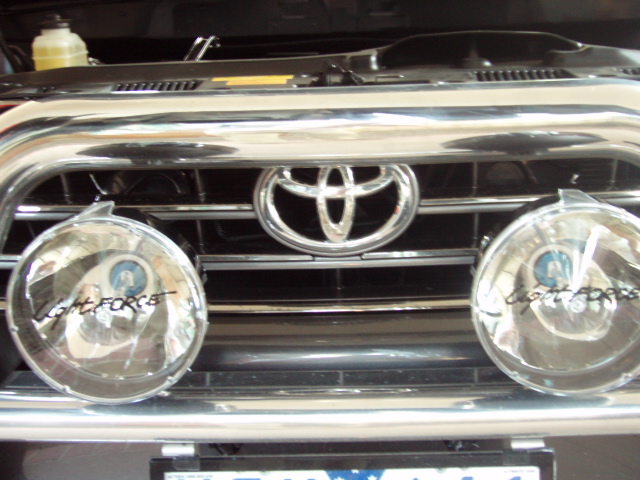

Eventually I found a spare afternoon to install my driving lights.
I ended up buying HID Lightforce 170 striker lights. ($620)
Note the blue centre bulb holder on the HID lights. :D

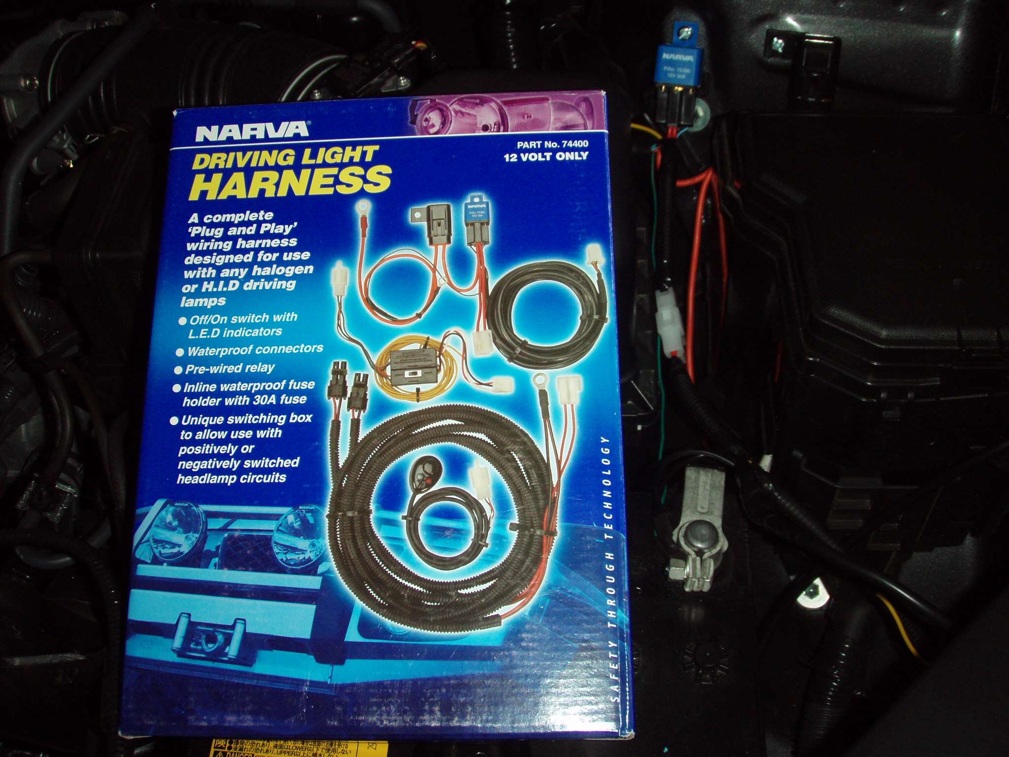

This post by PaulG was invaluable: UPDATED: Wiring in my spotties :clap:
The post shows the best spot to enter the firewall which was very helpful. It is a large rubber grommet marked with a white V behind the air filter box which comes out under the glove box.

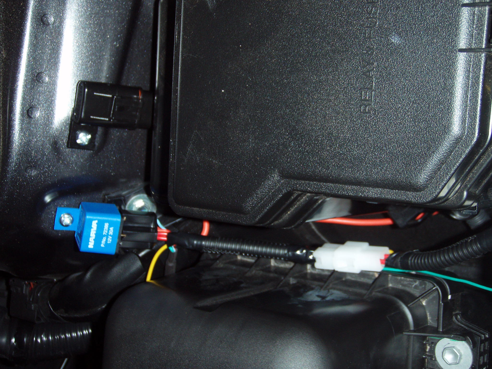

I used a Narva wiring harness which is designed to just plug together. Part No. 74400

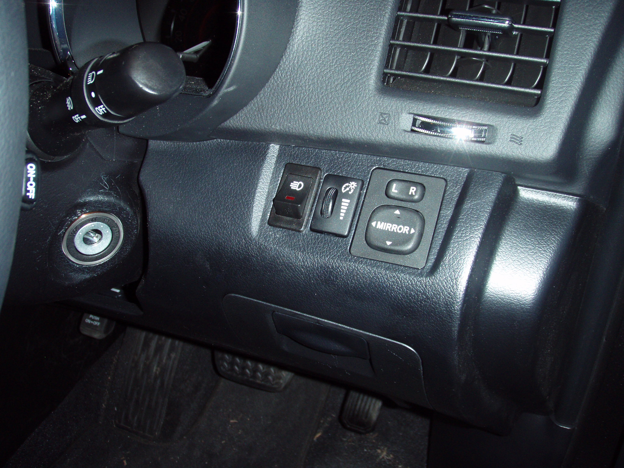

I aslo used the optional panel mount switch which goes with the harness. Part No. 74410
The switch fits into the blank next to the instrument light switch - I had to cut some of the plastic out from behind the switch to make it clip in.
The relay and fuse, that come with the harness, also both fit nicely above the fuse box using the existing bolt holes in the engine bay.

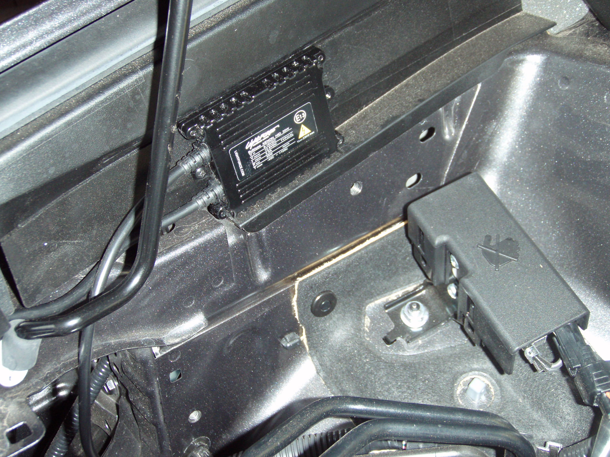

I also had to fit the HID ballast which fitted in on the plastic panel running along the each side of the engine bay.
I still have to adjust the lights at night - but they worked first time and the clip and play harness made it almost fool proof.

The lightforce lights have a ballast (as shown in the pics) and an igniter which is closer to the lights (now right behind the bumper bar). My wires enter the car in the holes where the number plate screwed on before the nudge bar was installed.
