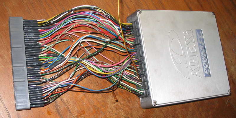

you shouldnt have to chop up your loom as you can get the PowerFC for the 2ZZ celica i'm quite sure they'd be da same....

Unforteunately the wiring loom is different on the stivo than what it is on the celica

DAM! thought we might get away with it easy :) i'm guessing that wiring may not be too different.... might be a matter of just repinning the barstard! the powerFC is a cool move is your staying na ect.... i havnt looked into it too much though i really dont want to mess with the thing too much as they are a freakn good setup as they are..... that what i got it for... for messing around i've got the cressida :)

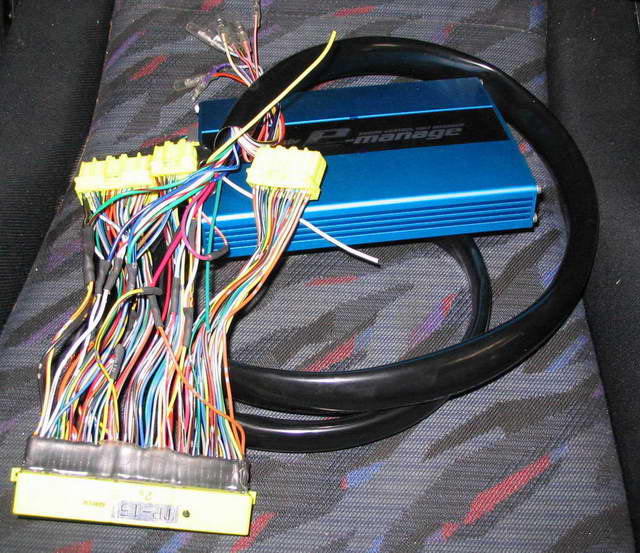

there is a 2nd hand 2ZZ corolla ECU on E-bay that someone could perhaps make a loom out of aka MAP81s E-Manage loom...
it would be easy to make a celica powerfc work on a sportivo. just get a fields harness and repin it to suit.
That's similar to what I did with my JZZ30 soarer powerfc so it works on my JZX81 motor and loom.
there are also other toyota models which share the same or similar looms to ours. I got this list from map81 a while ago for when i was hunting one down for the unichip.

You can even buy the HKS F-CON looms which are basically a fields harness which have the F-CON wires spliced into them. I've wired a couple of emanages to 7MGTE's using second hand F-CON harnesses now.
