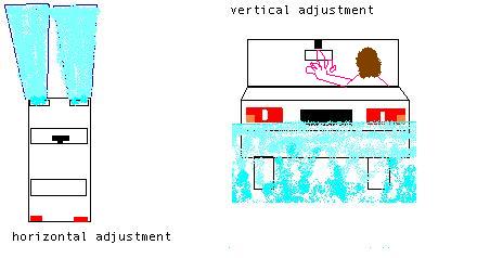

There should be headlight adjustment dials behind the headlight enclosure. They are usually grey and the size of a 10 cent coin.
One adjusts the light beam horizontally and the other vertically. You can do it by hand or using a socket wrench to turn the dials.
A good way to adjust the aim, is to park your car on level ground about 5 metres away from a wall, which you then make a marker that is just above knee level. Keep the engine running and headlights on and start adjusting the dials.
The reason why some people running around with HIDs blind others on the road, is because they have not bothered to do the above after having them installed in their car.
Vertical adjustment dial = adjust the light beam up and down to avoid lighting up a motorists rear window and cabin when your behind them. Adjust it, so that the beams only light up their rear bumper.
Horizontal adjusment dial = adjust so that your right headlight beam does not light up the opposite side of the road on to on-coming traffic.
With the left headlight, make sure you adjust it so that the light beam side cut off lights up a bit of your left hand side, but not too much. The light beam side cut off should be approx 50cm - 1 metre from your left front side fender. This will allow your left headlight to light up the left part of the lane like the gutter so that you can see kids, animals, drunk ppl, etc that might suddenly go on to the road from the footpath.
