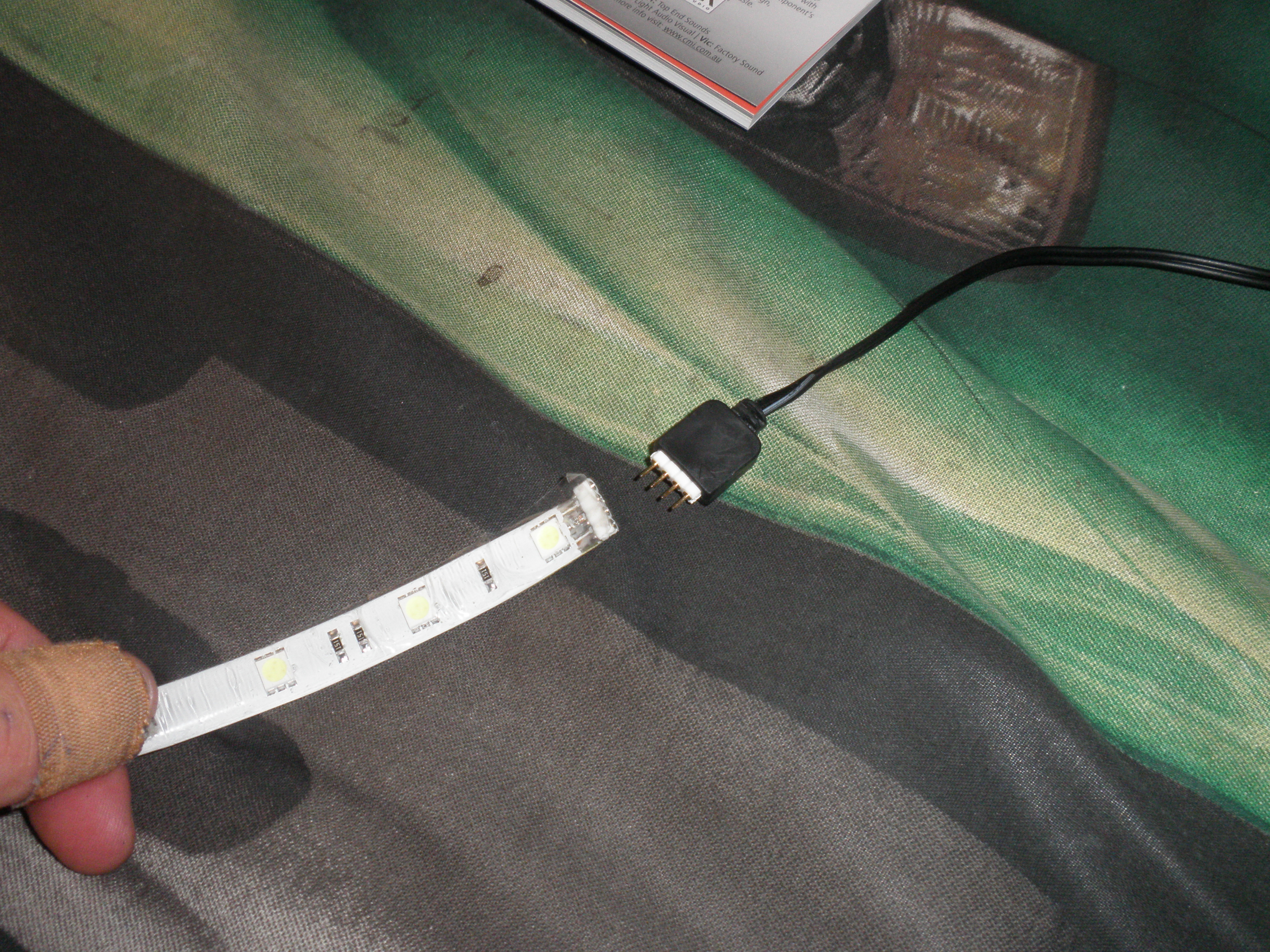

Old thread but i seen something the other day and thought that is perfect. i went up to Newcastle with a mate to pick his new liberty up and he started modding it before we even got back home. Stopped in Sydney to get a few things done including LED light swaps. he also had some thin LED strips put in the boot to lighten things up and they would solve the darkness issue in the Aurion’s boot. They are a simple thin LED strip that simply clips to each other with adhesive strips on the back to faster to the ceiling of the boot. 3 seems to be the magic number in boots and an Aurion boot is slightly bigger than a liberty’s but i think 3 would still do the job. Then there is a "harness" that plugs into one end of the strip and then into the T10 bulb socket in the boot. Dead easy and looks great. I am trying to get hold of some pics so stay tuned!

It most certainly is. You simple clip as many LED strips together as you want (within reason, I’m sure you can’t go on forever) peel back the adhesive strip cover and attach it inside your boot then get the harness. One end connects to the last LED strip then the other simply connects directly into your T10 Socket in your boot. Easy as that!

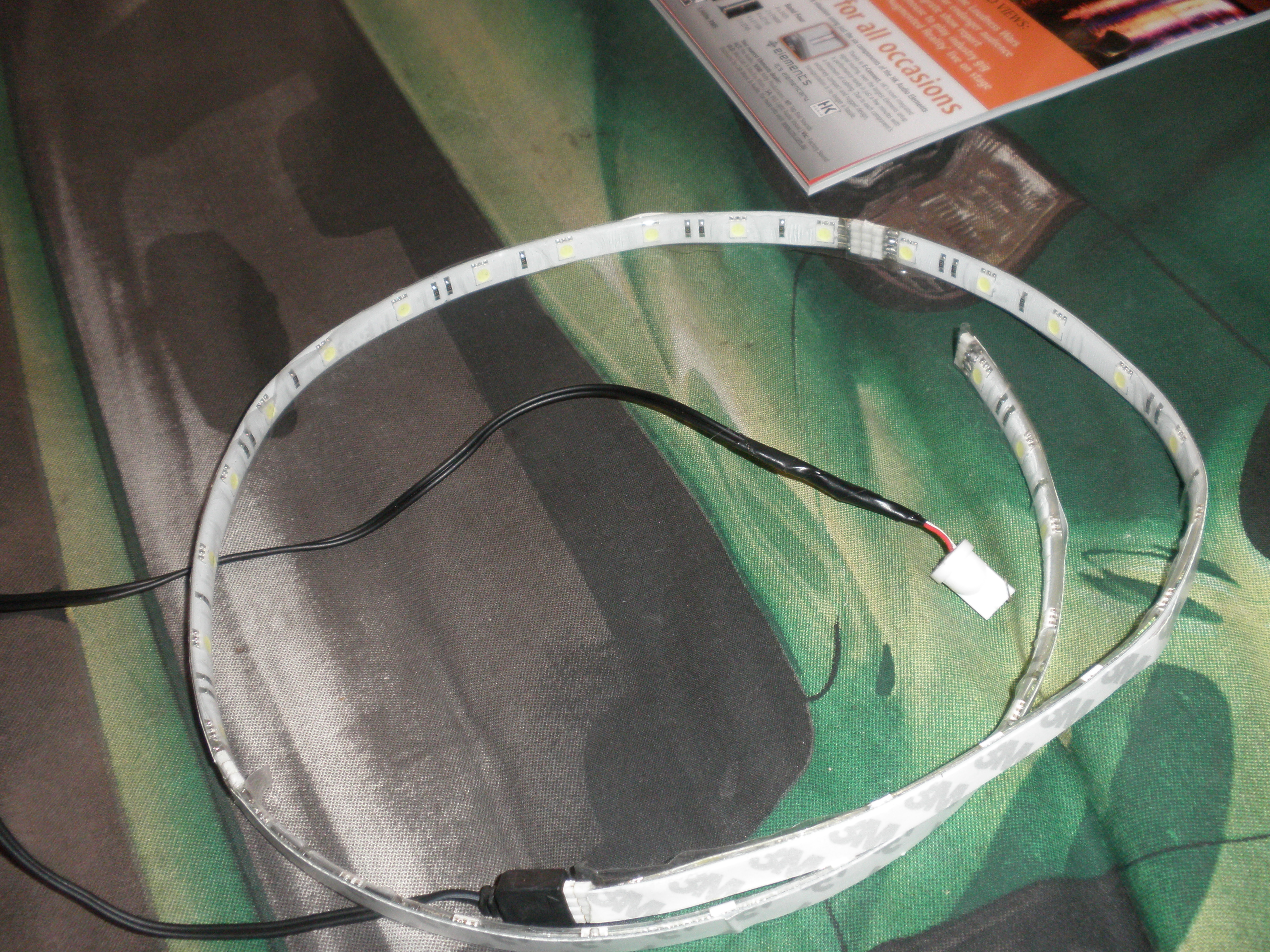

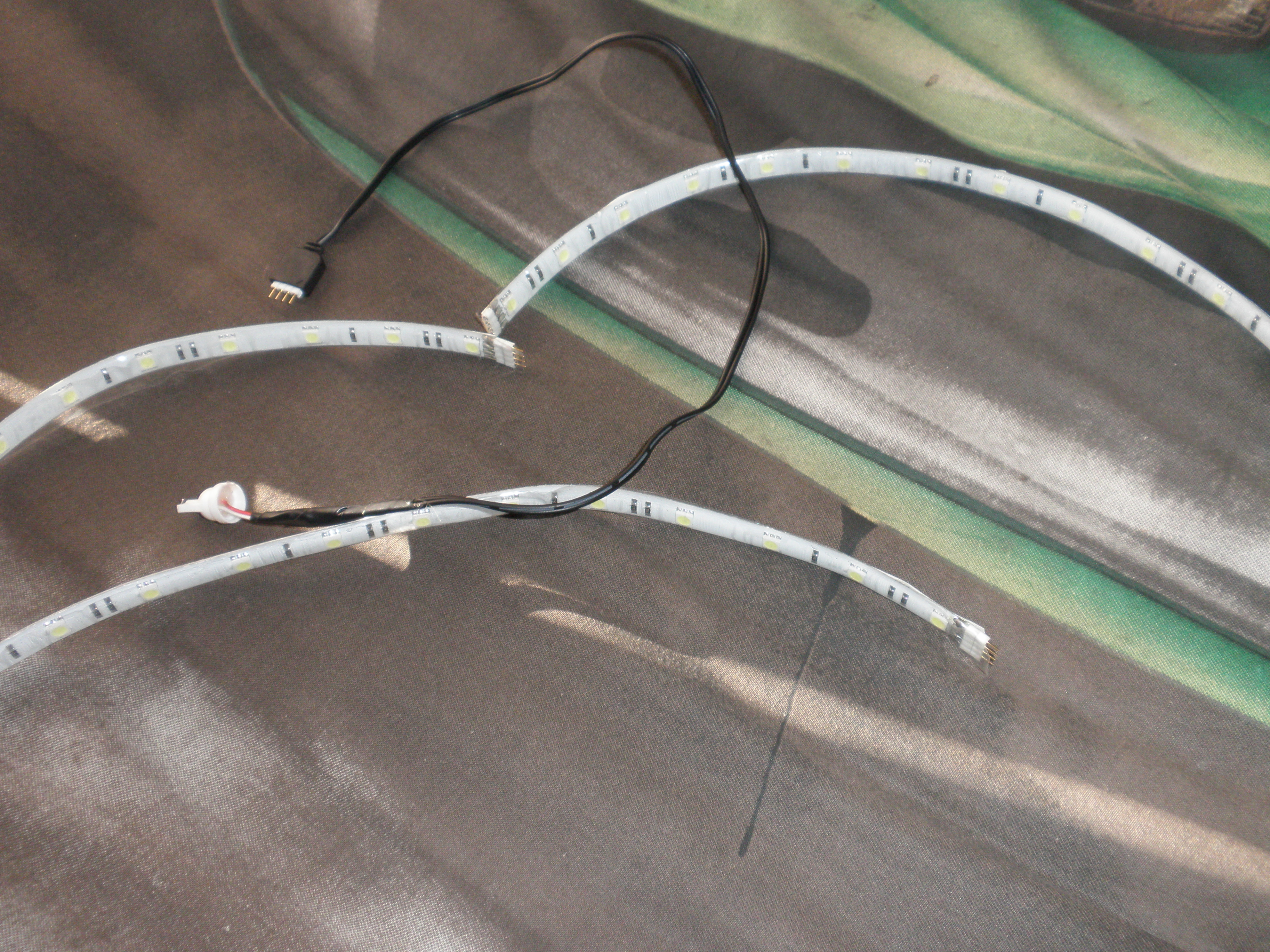

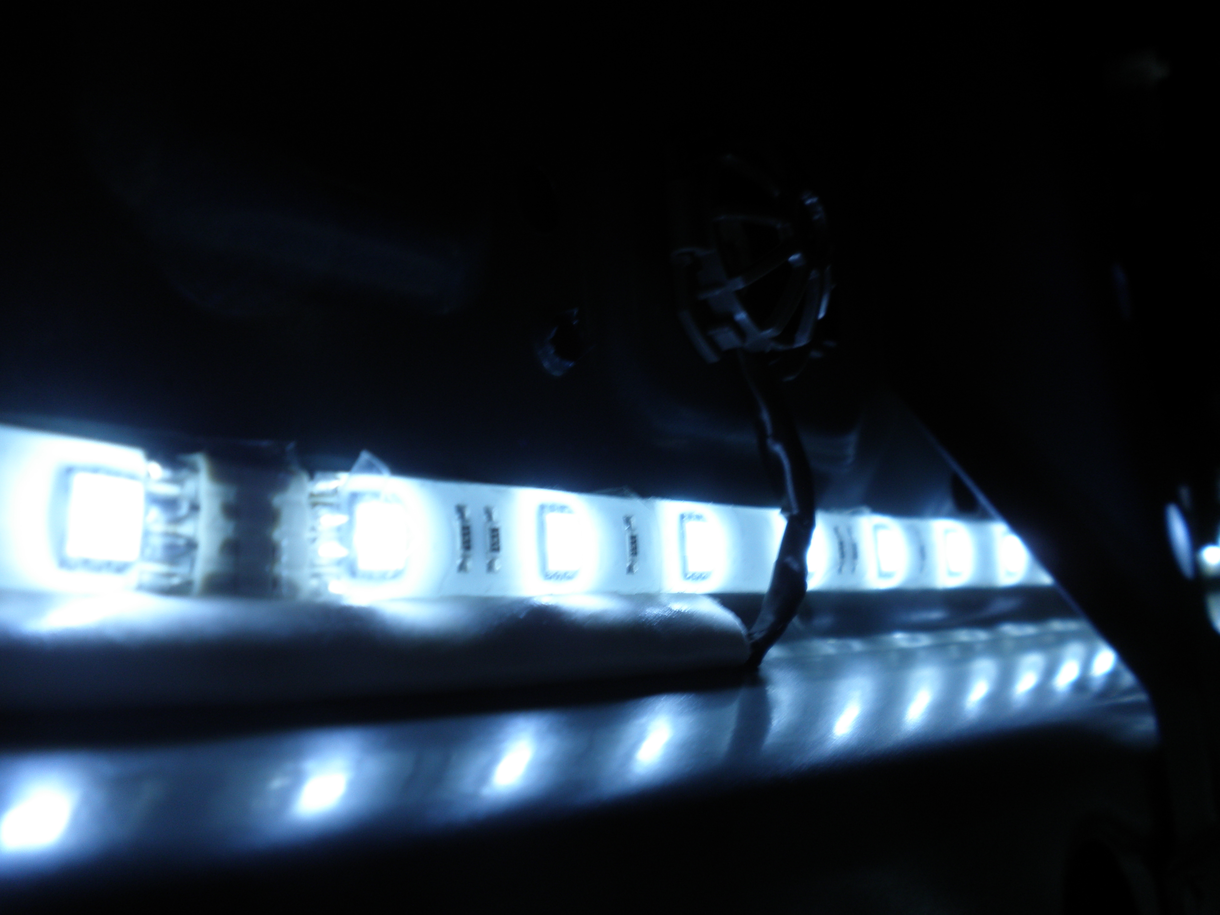

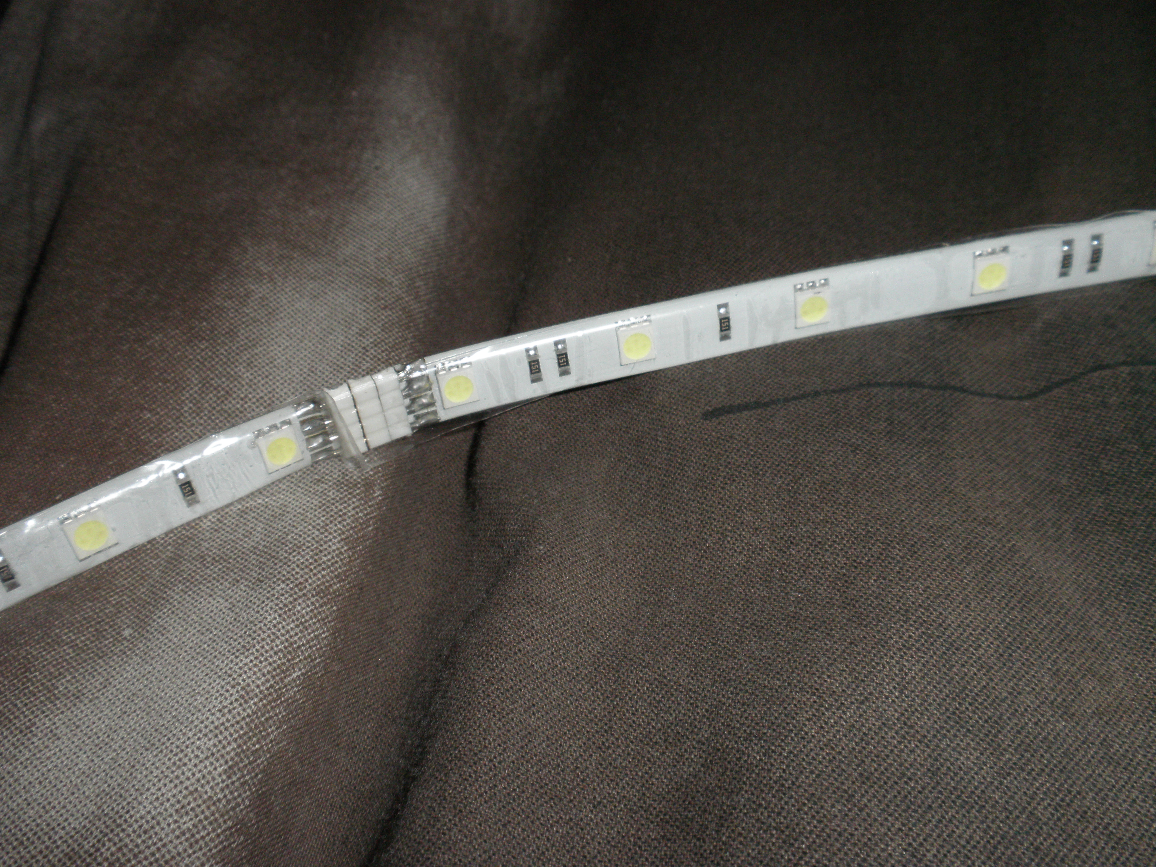

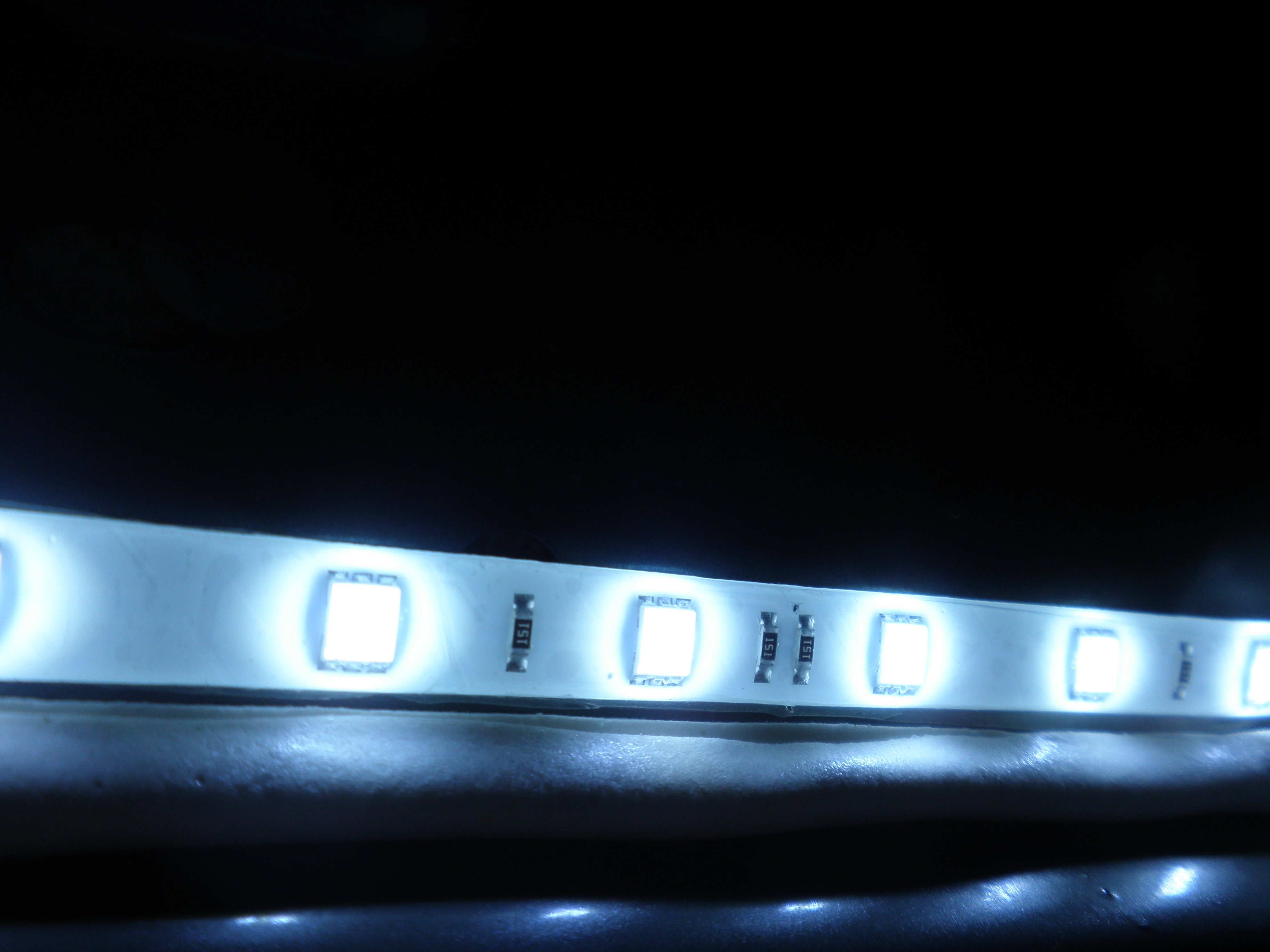

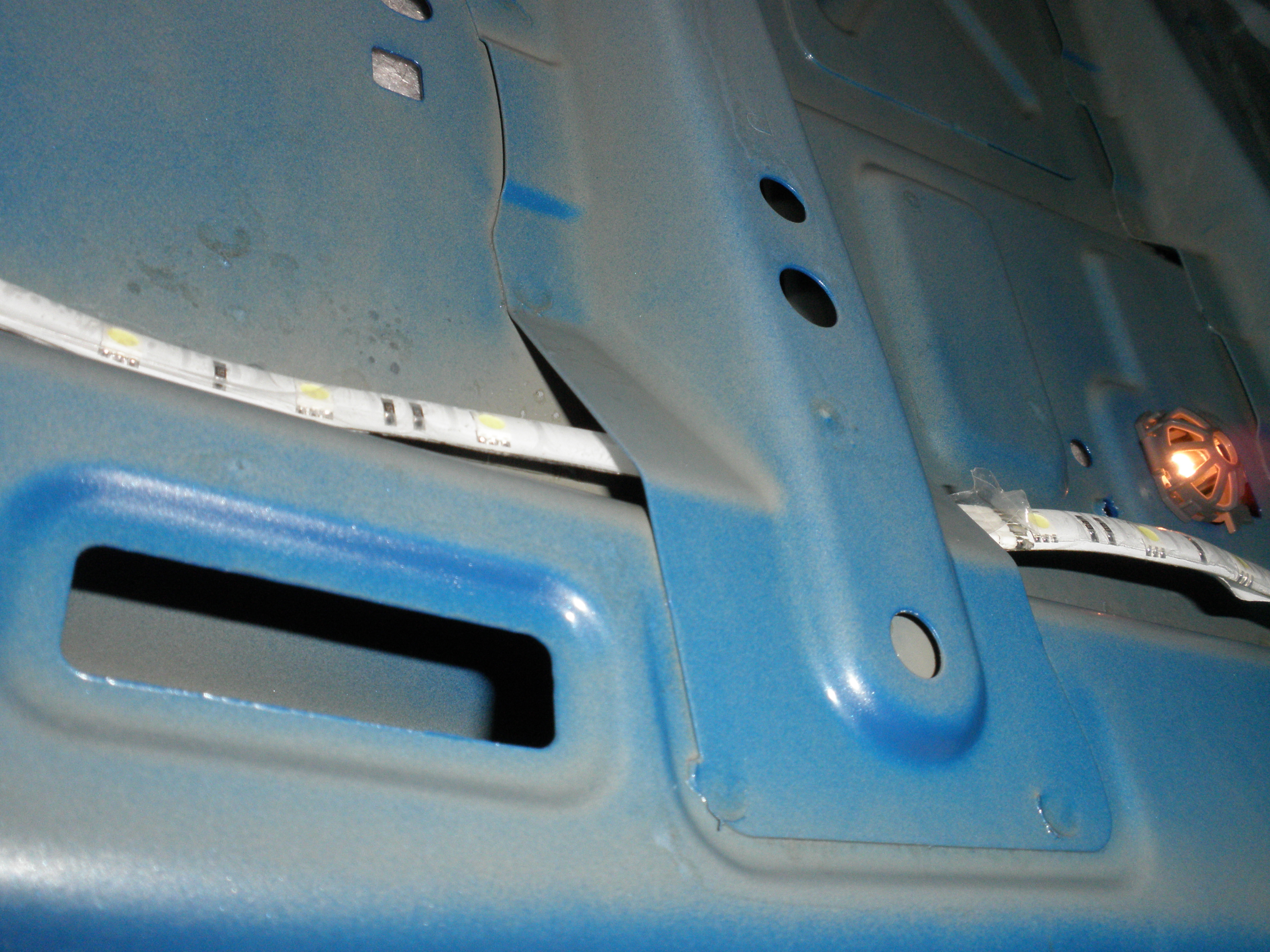

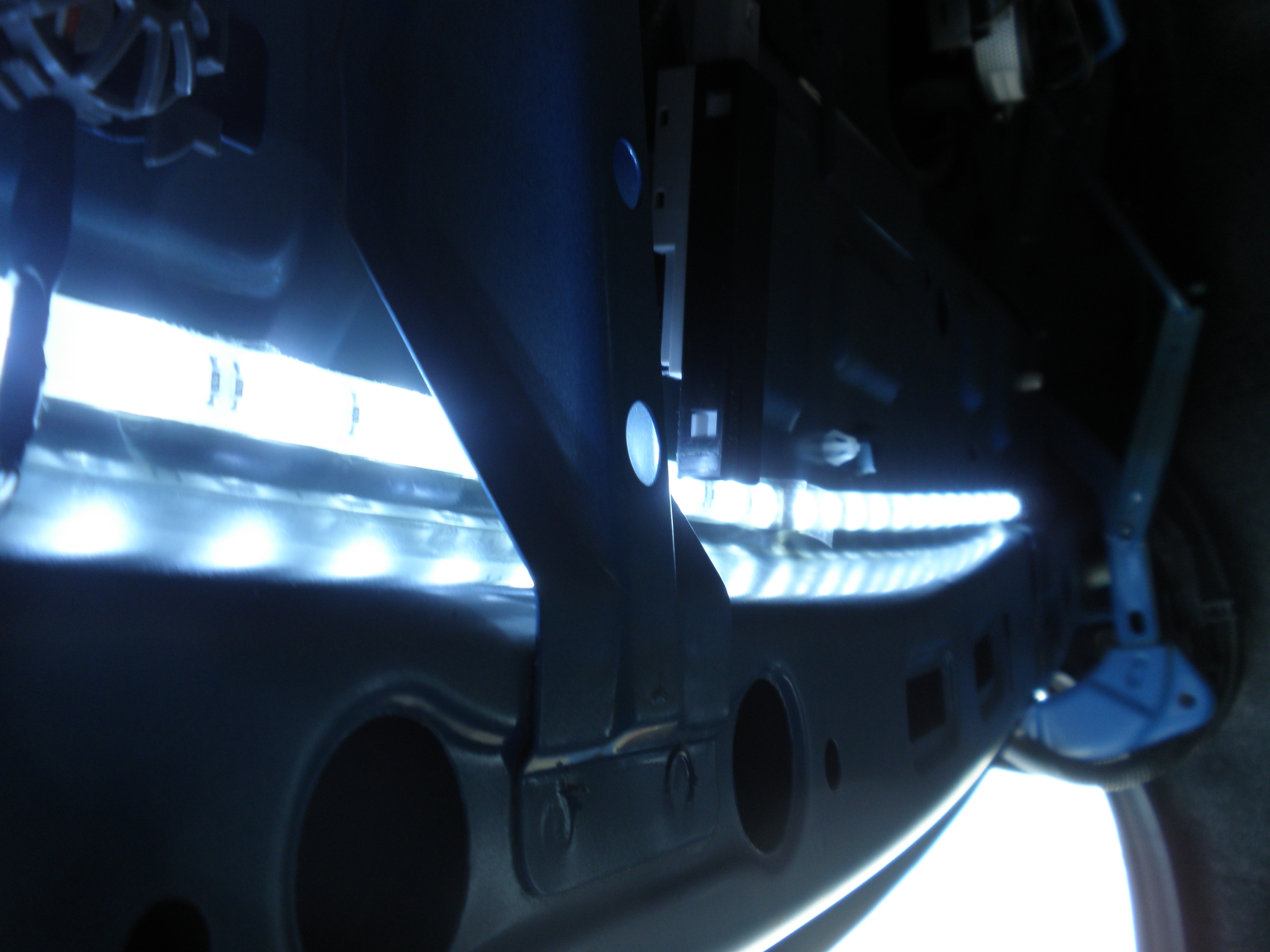

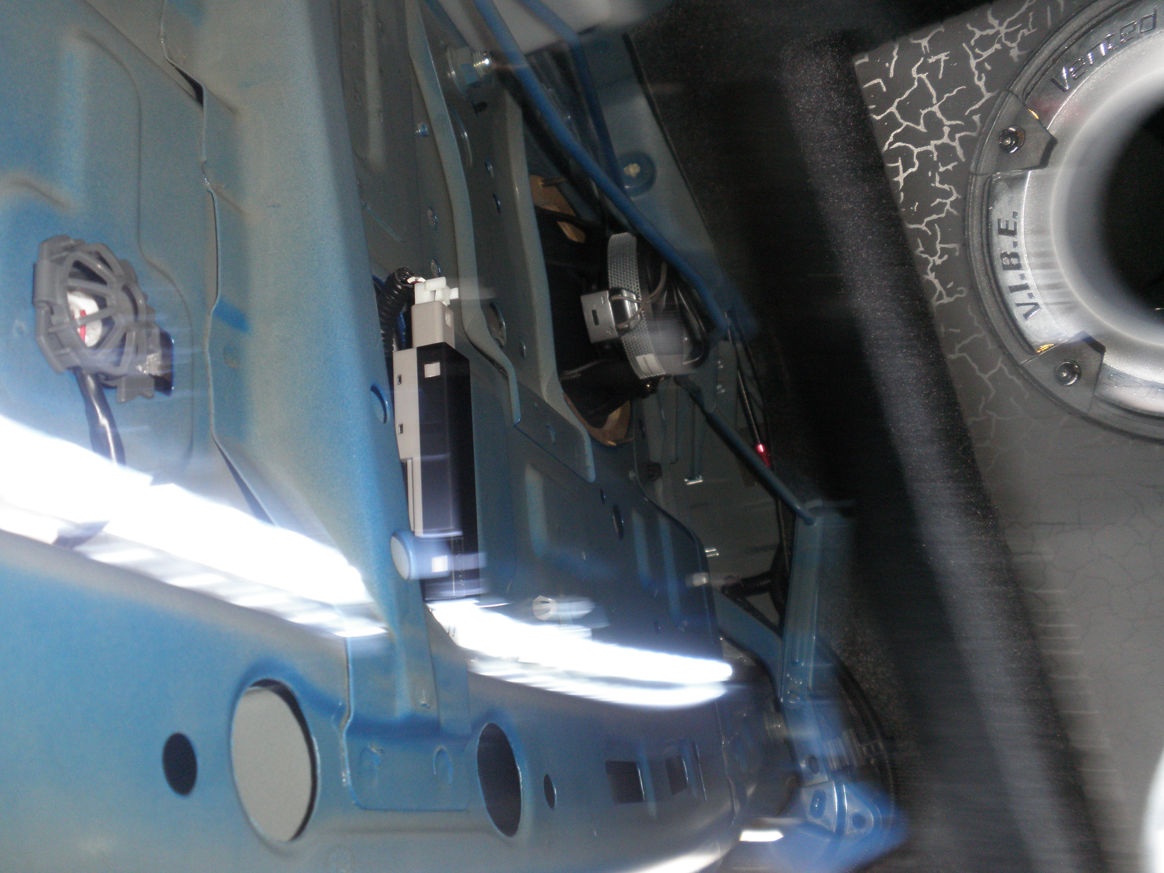

So as mentioned earlier i installed the LED strips into the Aurion after work, they sit just inside the lip of the boot out of harm’s way just nicely with the harness running back alongside the LED strip, see attached images.
HOWEVER..... i have a drama which I’m sure one of the clever guys on here will be able to point out why it does it and how its best fixed. When you shut the boot the LED's do not switch off. I only found this out by chance as something told me o pull down the ski port and see if they had gone off which they hadn’t... so just for a long shot i closed all the doors to see if they were randomly switched to the dimming interior light but no joy. So i put the T10 wedge globe back in and sure enough it switched off so to be more precise i pulled the sub and amp rack out of my car (which made me as happy as the dude that takes one for the team and does the fat chick!) so i could see right into the boot just to be sure the wedge globe was off and it wasn’t that the light output was so poor i couldn’t see it illuminating anything and sure enough LED stays on T10 didn’t.. Then of course i realised i didn’t need to of pulled the gear out of my car as when using a screwdriver to flick the latch on the boot i got the same result which sucks because the look awesome, any ideas boys?

FYI, Toyota use ground switching for most of their electrics. This means that the positive terminal of the boot light will always have constant battery voltage present.
So get yourself a multimeter and with no load on the boot light circuit (ie. unplug your LED's etc) and with your boot latch locked, measure the resistance between the negative terminal of the boot light socket and ground. You can use the boot latch as a ground point, otherwise an amplifier body ground will do. If you measure any form of resistance. Ideally it should be an infinite reading. It won't take much contact with ground somewhere to mess things around. If you are seeing a few megaohms between the negative terminal and ground, then this is all it takes to get the LED's to give a dim glow. Obviously the less the resistance, the brighter your LED's are going to light up.
If you are getting an infinite reading, I would then be leaving your LED's the way they are and try to disconnect the connection to the light socket. Then use your multimeter to test between the negative terminal of the LED's to ground. Same deal as above. If you get any reading there that isn't infinite, I would make sure your LED's are completely isolated from the body of the car. If you get an infinite reading there, then I would be sussing out your connection to the lamp socket itself.
Those pictures... despite being massively sized, do not really give me a clear idea of their construction. Those LED's don't appear to be the ones that are completely sealed in silicon. They do look like there is the potential for part of it to ground itself with the body of the car. If you ask me, I'd reckon the issue lies in that.
This is why I use and recommend LED strips that are completely sealed when fixing them to metal surfaces of the car, or to where they may potentially contact metal surfaces. The ones I use look like this:
