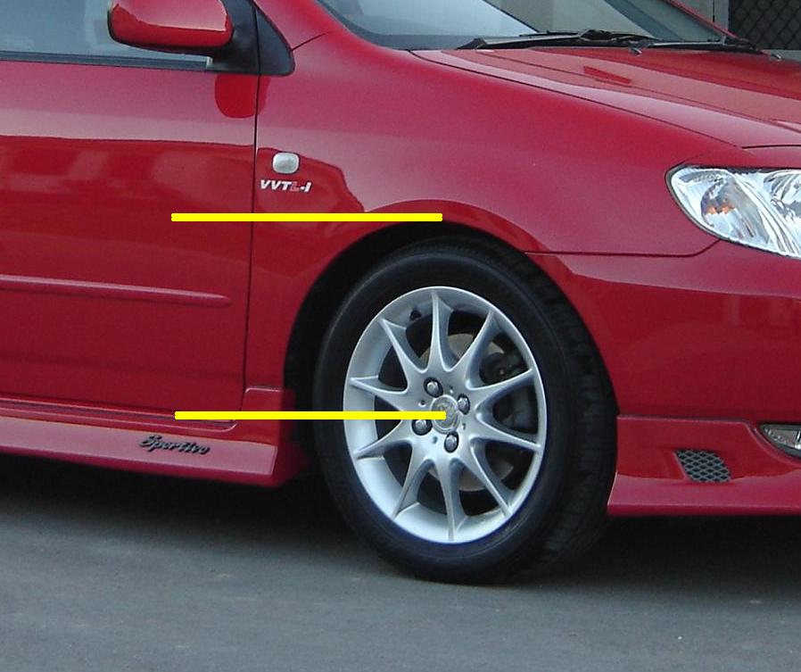

Dave, do you reakon you could measure to the highest point of the wheel arch. That's the easiest point for comparison.
Can you do front and back as well

you're meant to measure from the wheel center to the guard to measure the height for comparative purposes, then things like wheel diameter, tyre width/profile/pressure etc dont come into play.

the measure from hubcentre to the highest point of the wheel arch is what I want...
345mm on my car with king lows (30-35mm drop)
Front: 380mm
Rear 390mm
Those are give or take a little due to a couple of factors.
