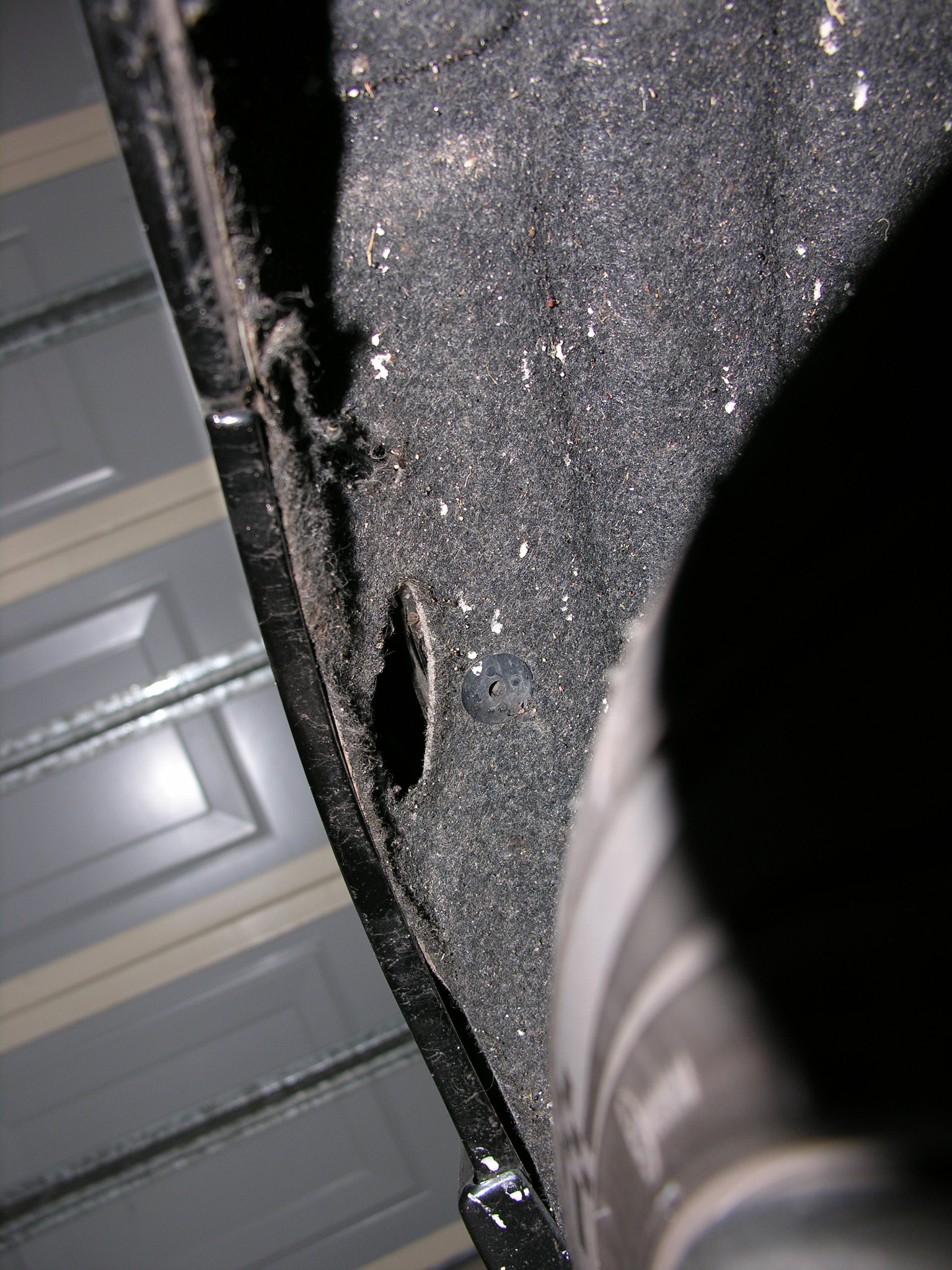

I have 20inch x 8.5 rims running on a 245/35/20 and i just got my car lowered with Pedders sports ryder springs.
Problem is i picked the vehicle up and it drives fine, but any slight dips in the road the tyres rub on the plastic inner guard. I looked underneath and the inner plastic guard has a lump/lip where its rubbing.
It shouldnt do my tyres any damage as it should just wear down the plastic eventually. But does make me cringe when i hear the scraping noise. No panels are touching though - thank ***!
Im thinking, i can let it go and see if the plastic wears down, or i could get underneath and cut away the lip on the innerguards. Or if no one else has had the same problem, take it back to pedders and say what the F***K.
Has anyone else with 20inch and pedders lowering experienced this. If not i might take it back to pedders, maybey they installed them wrong.
I seen some past forums on this site, but you guys have 19"s on your cars, but should be the same as all our vehicles should have the same tyre rolling diametre. Have you guys had any problems?
I do have a ATX though, and maybey the inner guards on the ATX are different to the other models?
Its a bit annoying, can anyone help me out, any info would be apreciated.

The tyres will "wear" before your plastic guard does. You need to sort it out ASAP as you don't want to make your tyres unsafe. Me personaly, i think you should have gone for 18's or 19's, 20's are too big if you want to lower the car as well. Your ride comfort will be pretty ordinary I would have thought with that combo.

picture please, and a pic of inside the tyre(to show the gap left).. it might be too late, but a change of spring might solve the problem..

I know what you mean, sort of same problems when i jumped up to 22"s on my holden captiva, the bigger wheels would cause rubbing on the guard. But with this problem, dont know much about suspension.
Cheers mate thanks for the info, your right, Im going to make a appointment to see them on the weekend. I can be very persuasive when i need to be, and im sure they will be sympathetic to my needs and we will reach a solution.
I think once we shave off the node/lump/raise in the plastic inner guard, it should be fine.
Cheers, im going to try and shave off the lump on the inner guard and see how i go. But till then im just going to drive my other car. The ride is still pretty good actually, its only on dips when it scuffs and it sounds bad. But speed bumps are fine, and is normal road driving. But i planned for that when I put a softer low profile tire on, so it would smoothe out the ride.

Large wheels + lowering will usually always = scrubbing, unless the guards are already pumped from the factory.
The fully sik uleh's have methods on fitting those large, oversized wok rims on their fully fully fully fully omg omg cars. It involves rolling the hell out of the guard, but if it's the liner that's the main issue, you'd need to box your guards a little as well (which involves plastic welding, an interesting niche trade).
You can always raise the height, but I know how it feels to have your ride low. It does look the tits.
Also you could always put 19's on there, they'd still look somewhat big and you could maybe lower it even more then.

With 20" wheels the increase in overall wheel diameter is less then 12mm (6mm each side) over standard, not enough to cause a problem.
The scrubbing of the inner gaurds is because the rims are wider, so the outer edge of the tyre scrubs the inner guard. I have 20"x8.5" rims with 245/35 tyres fitted, had it lowered and had the same problem so stuck the original spings back in. I recently drove from Darwin to Perth with the ORIGINAL springs fitted, cargo of one passenger and around 120kg of luggage in the boot and on the rear seat. The road was not all that rough but the odd dip in the road still caused it to scrub and it DID wear a hole through both rear inner gaurds. I have some rub marks on the front inners too (The tyres where fine). I think any size rim (18, 19, 20 etc) will have similar problems with a 245 or larger tyre fitted.

I figured it was something to do with the offset. But as the rims are paid for (about 3k) then im gonna have to work around it. I think, re-shaping the guards will be the first step, if that doesnt work, maybey custom guards, if thats not accessible, ive got the old springs and will have to put them in, as it didnt scrub with the standard springs in.
Thanks for the info, and the attachments. I tell you what, i learnt so much about this vehilce since i joined this forum, its amazing, the vast types of knowledge out there about this vehicle.

Here's a pic I just took of the rear inner guard. It's the same on both sides.
There are actually two holes, the big one at the bottom and one smaller one just above. Under the smaller one is where the plastic bumper attaches to the body of the car. It has actually started to wear the plastic away from the attachment point. This damaged all happened with the car at the standard height on the trip to Perth as previously stated. No more damage has occurred since the trip as I rarely load much weight into the vehicle, I was also traveling around 130-140 km/h so the dips in the road were amplified.
I had King sprigs fitted originally but had them removed within an hour once the problem was noticed. The guys at the suspension place had no idea on a remedy. After the drive to Perth I decided I would just have to live with the car at the standard height, it still turns plenty of heads.
You would have to remove too much material from the inner guard and bumper attachment, possibly compromising its strength.
I believe the only solution is to use a narrower rim and tyre or leave it standard height.
