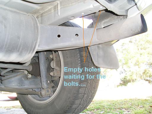

4 bolts for the bar which was easy as, just tricky as it's heavy and with 1 person doing all the work, a bit fiddley.
(10mins)

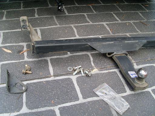

Hey peeps, pics as promised.
Car - RAV4 Cruiser 2002

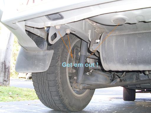

Before shot 1 - Under the car, left.
Before shot 2 - Under the car, right.

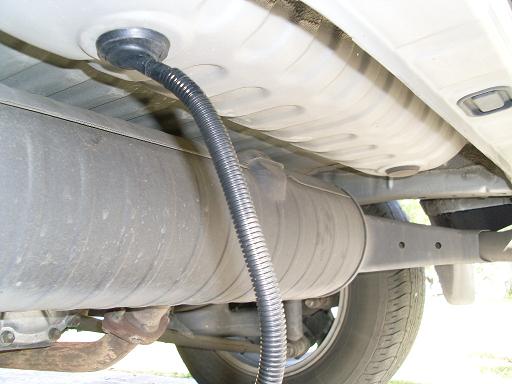

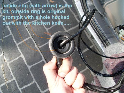

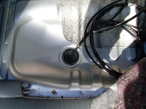

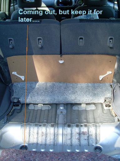

Lift some carpet and the tool storage area, and there's some easily, removable grommits

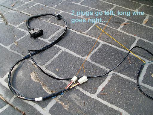

The Toyota harness.. oh yeah, bring it baby!

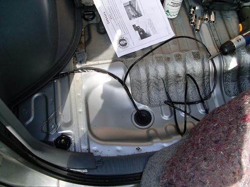

Pic of the grommit out and my arm showing where the wires are eventually going...
Cut a hole in the origianl grommit (smaller than the new grommits diametre) and insert.
The new grommit has a grove where the oldie slots into, like a tyre going inside a rim, sorta, but on a smaller scale.
It's in, soooo easy.
same but underneath,,,,

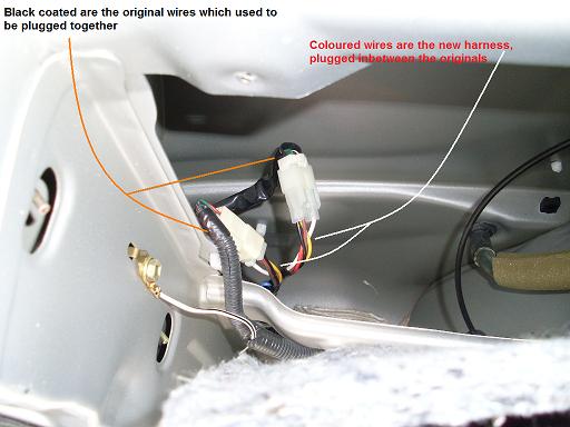

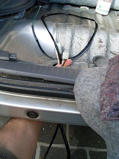

After you have pulled the plastic away (only 4 screws and some force), you'll reveal the rear lights plug.
You unplug it, insert the 2 plugs from the harness (there's only 1 way this works so you can't get it wrong)
1 side COMPLETED ! Geeze that was hard ;)
Getting there..
with 1 side done, another to go which is only 1 wire but slightly trickier
(this one does your right blinker, the left side controls the rest)

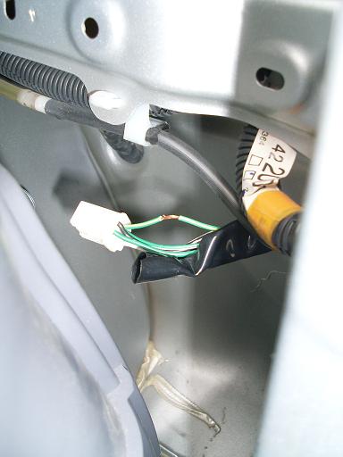

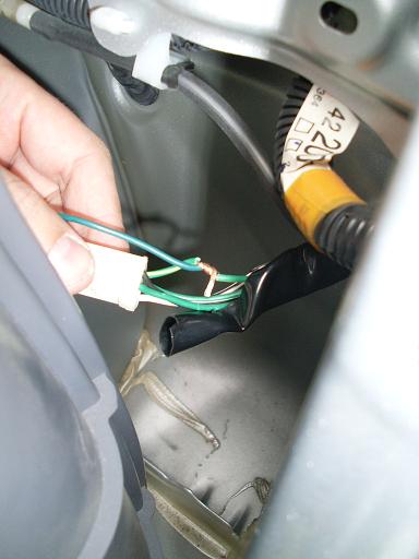

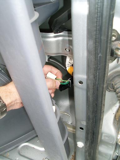

Ok, pulled the plastic walls back to get some better access.
Unplug.
Cut back some black covering to reveal the wires.
you need the GREEN/YELLOW wire (ontop of my finger)
Cut back some insulation to get to the wire...
Wrap around the new wire, and solder, and re-insulate with electrical tape.
(not all pictured but i'm sure you can imagine)
Put it back together and the inside wiring is done.

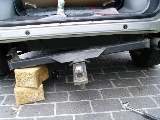

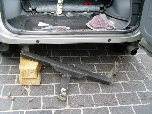

Well the bar itself is only 4 bolts...seriously.
I'll show what i have but i didn't do the completed shot! Doh....
Bit hard with the weight and 1 body, so you can see my levelling technique too.
Sooo clever ;)
You need to drill 2 tiny holes for the plug to be secured, but it came with 2 plastic ties, and i just used that for now.
Holding well.
