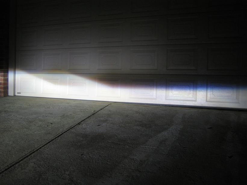

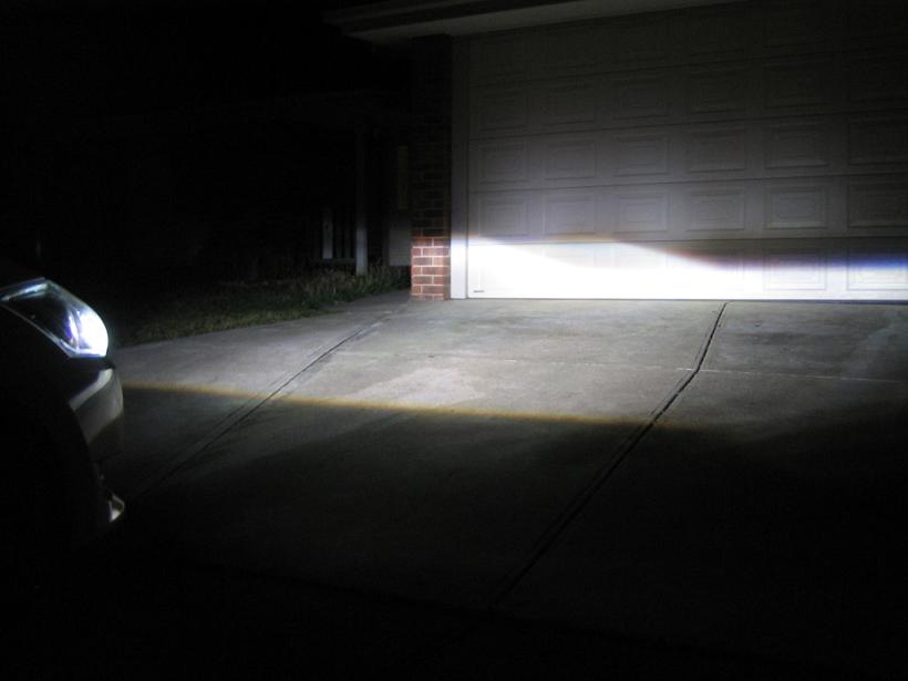

Wow! I love the colour on your cutoff.. damn, all cars should come with projectors as a standard... =(
It's obviously so much better compared to reflectors, in terms of even light spread.

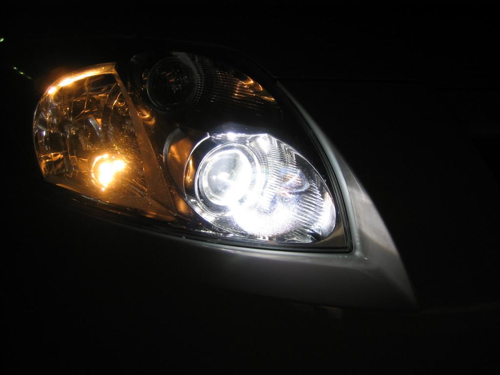

I got a HID kit on my Corolla.... works well enough :) I have the halogen projectors though, you have reflectors.
What is the difference between projectors and reflectors? :-/ ( well obviously i can guess the projector is the source of light producing a divergent beam of light in front of you and the reflectors directs an emitting light source in a particular direction...) But i want to know a bit more than that....if there is any?
Reflector headlights spread light unevenly and have a tendency to cause more glare and less brightness where required. Projectors on the other hand are very focused and even. The only disadvantage with the projectors is that it doesn't put much glare outside of it's designed focus which as a result makes it difficult to see objects outside of its beam pattern. Not very friendly on night time mountain drives.

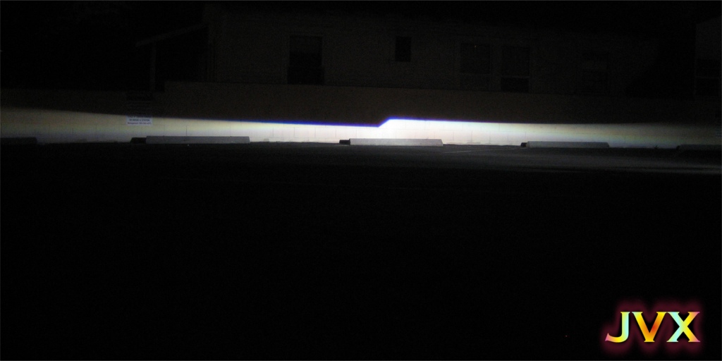

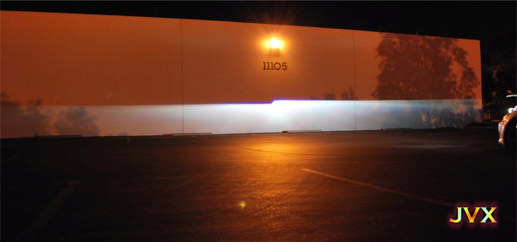

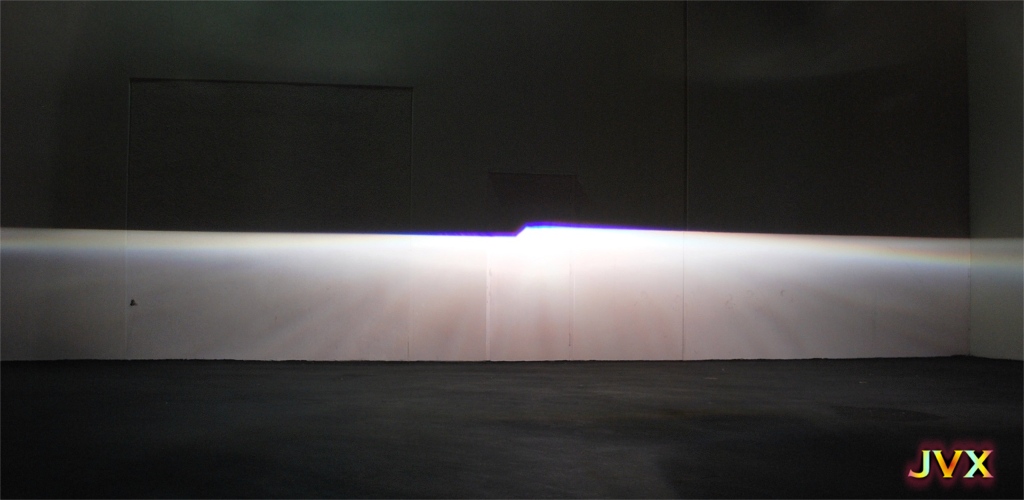

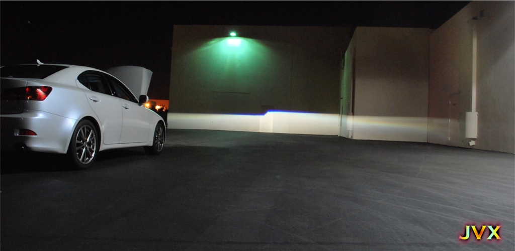

This is just so you can see the difference in the design:
And this is what a projector output looks like:

Actually according to those guys, my halogen projectors with HID are also crap and illegal. Go look at some of their galleries... impressive.
