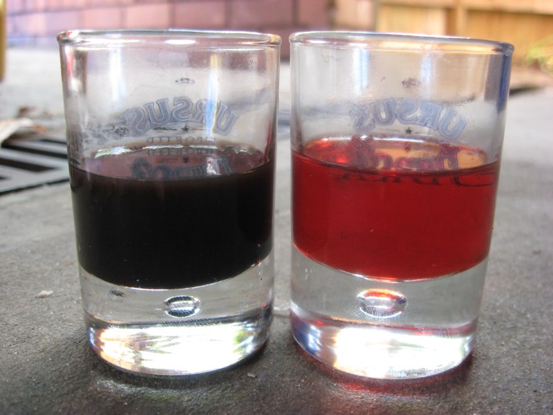

Another edit: In case anyone wants a bit more convincing, here is a comparison of some new and some used (after about 75,000km) transmission fluid (from a manual box actually, but it runs ATF fluid). No prizes for guessing which is which.. yes they were both the same colour at one point.
