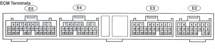

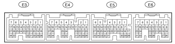

Ok I planned to start a new topic but seeing that the discussion here is closley related here goes. I've been monitoring the MatrixOwners website alot considering the similarities between the RunX and the Matrix, however I uncovered a post in which some one wrote Apexi Japan re the Power FC for the Matrix and got the response that it was made only for the Celica. It appears that the ECU harness of the Matrix differs a lot from the Celica harness. My question is, what does the diagram of our harness look like? I didn't get a manual with my car so I have no idea. I also found information stating that the Stock Ecu learns the Apexi S AFC 2 and virtually cancels it out making it a useless mod. It was said that the UniChip is the only piggyback to date that stands up well to the stock ECU. Can the Unichip be tuned by my local dyno tuner? Does it have a controller
or interactive interface? What other ECU options exist for the RunX/Stivo?
Here are some pics of the Matrix & Celica Harness

MAP81 has a working emanage on his 1zz-fe but as far as i know nobody has used on in a sportivo
Yep I have but on a 1ZZ and on an otherwise stock car I got an 8.6kw Gain at the wheels and a noticable increase in torque.
Have a look HERE
