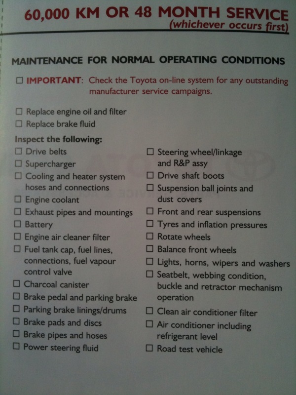

straight outta the service manual for my TRD...
obviously, yours will be slightly different (ie, lack of supercharger to inspect), but it'll be roughly the same... :)
