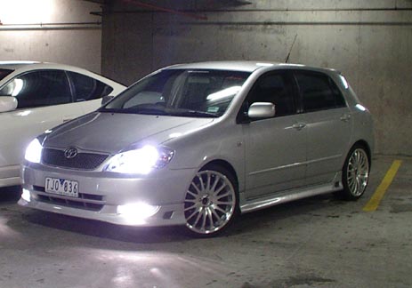

Just painted and fitted the front bumper -
