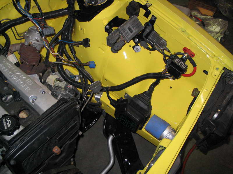

it's not hard to relocate the battery to the boot, you can buy a nice ceramic battery post for the bay to bolt the old positive battery lead to, then get a positive lead made to run to the rear of the car (there's a few ways of doing this, just ensure if it passes through the body it has a suitable grommet so it wont get cut through, ever!
Also make sure you have a good slow-blow fuse on the line at the battery to ensure in the event of a short on the main feed, you dont burn your car to the ground.
You can purchase battery boxes from autoparts stores, some are better than others. Make sure the box is bolted securely to the chassis, and if you're putting the battery in the cabin you will need to use a dry cell battery unless you seal the box and vent it to the outside of the car.
I ran mine through the firewall on the main grommet on the passenger footwell area where the body loom runs through, then along the loom area down the passenger sill to the boot. The earth strap was bolted to a ground down area of the chassis rail.
In this pic you can see the ceramic post I purchased from an autoelec supplies store along with the custom positive cable
