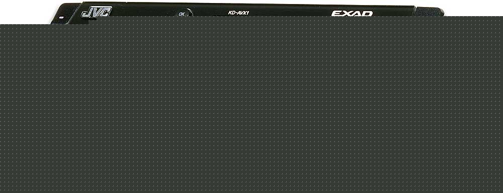

I've read what you guys have read, and you've now talked me into finding a head unit..
I quite like a few decks, but Pioneer and JVC have some of the more funky ones. I found the Pioneer 9650 and JVC Exad.
I've attached a picture FYI - what do you think??
The JVC has a built-it 3in monitor which you can watch DVDs etc on.. The pioneer is MP3 with graphics..
I'm leaning towards the JVC..
