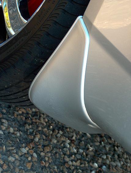

Hey guys I thought I would revive this thread instead of startin anotha one... I was thinkin (well I'm pretty sure) I'm gonna paint my mudflaps at DSports. I went there the other day (Dave is a legend by the way, a real great guy) n got a quote for a few things to be painted. Do u reckon I should do it becos a couple of ppl hav warned me against it. But I'm pretty sure I'll do it as Dave said it should b ok becos he will plasticise it (extra protection). So is there anyone who's done this? How has it turned out? Are they damaged yet? Do u hav to b super careful having them? What do you think I should do???

I got my mudflaps painted when I got my wingtips done and I havent noticed any problems with the paint peeling off or anything. (I got mine done at a different panel beater than DSports though).

I'd say do it yourself. Here in the US they sell color ,atched paint in spray cans. There, you can likely get it made to order.
All I did was clean the hell out of them. then, the MOST important part, spray it with a PLASTIC PRIMER to help the bond. then I spraded the color matched paint. I thought it would come right off, but it hasn't. Storms, dirt, mud, rocks, nothing hurt it yet. Been about 6 months or so.
Sprayed these myself with a colour match from Autobarn. If you prep the painted surface correctly and you can paint with a can properly then it won't be a problem. My rear mudflaps have been painted for nearly 3 years and no drama's :D

Thanks man exactly what I needed to hear, cos sum guy was tellin me "they will look good for like 6 months, then after that n a few rocks theyl look sh*t.... bla bla bla"
silverbuilt: did you use a plastic primer before spraying the final colour on. cos i was talking to a guy at a paint shop and he said you need this special plastic primer so that the paint would stick and not peel. was he correct??
definitely use plastic primer 1st then do the coats of paint then do the final glossy coat layer (with plastic gloss stuff)

just got my stuff, it costed me more than that...
Plastic Primer - $20
Paint - $35
Wax and Grease Remover - $11
Gloss - $14
thats like $80.... but think i got enough for 4 mudflaps
