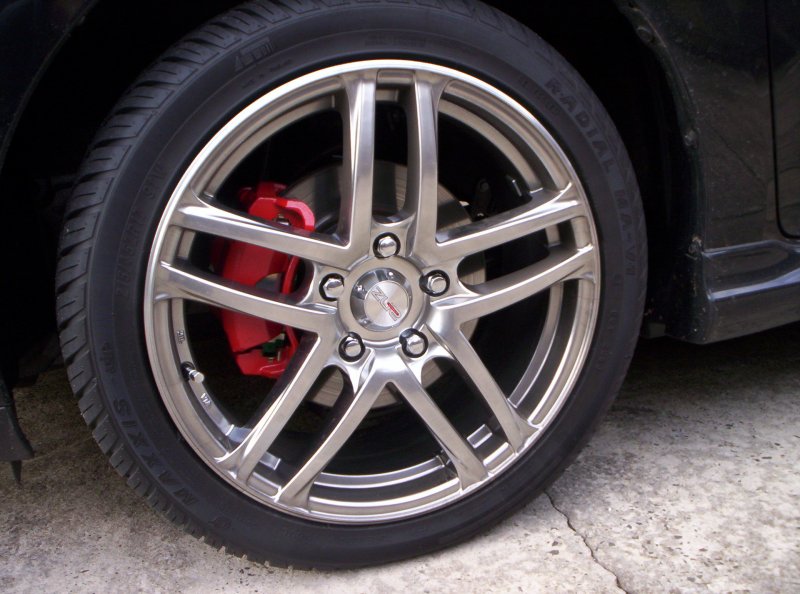

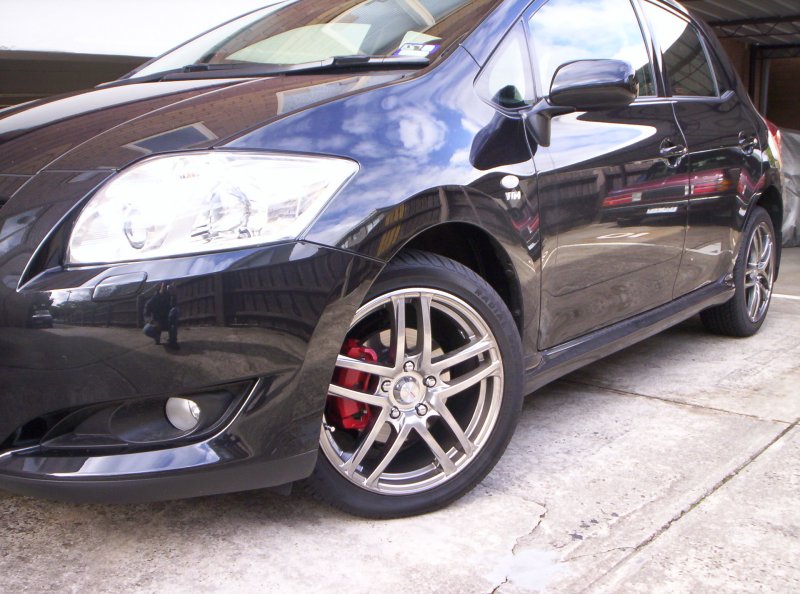

Was done buy they guys at "The Tyre Factory", the wheel shop I got the rims from, $150. Apparently it looks even better when the car is in motion, but cant see it, my gf won't learn manual, grone.
I know I could have done it myself but without a car lift, air ratchet gun, level driveway or time, it would have been an A-hole of a job. 150 bucks is reasonable I do recon.

I had it done at Cheltenham Tyre Factory (1242 Nepean Hwy), ask for Ray, they will need the car all day. Yes the calipers had to come off, thats why I had them do it, I dont have the tools. It needs heat resistant paint, I got VHT caliper paint in "racing red", $16 from autobarn. I'm very happy with the end resault, looks great.
