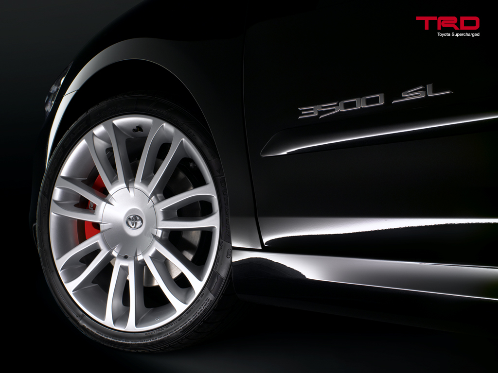

Strange you should say that. The TRD Aurion (or TRD 3500S & SL) has a different size to what you've been told to fit on your car.
From the TRD web site:
"The four 19x8" performance alloys improve brake ventilation and preserve
impact resilience. Wrapped in 245/35ZR 19 Dunlop SportMaxx
Performance tyres, they're the perfect link between the
technology of the car and the surface of the road."

Yes mate thats my point the 3 said tyre places recommended the wrong size.. Not sure on normal cruising but with 2 in the back seat the 40 profile would frequently rub..

But if he has a SX6 though, isn't the spring/shock setup different to the TRD, therefore effectively creating a different environment for the wheels.

Yes, a smaller environment. The TRD Aurion sits lower (and firmer) the the SX6.
I guess you'd have to measure the actual diameter of the springs in the SX6 then the springs in the TRD and compare. Just cause the TRD sits lower, doesn't mean too much for this equation IMO, on what I have read from here, I would deduce that the diameter of the TRD springs is smaller than that of the SX6, hence why the TRD doesn't scrub (unless those with TRD's are not reporting them scrubbing).....
I can't figure out any other plausable explaination....
