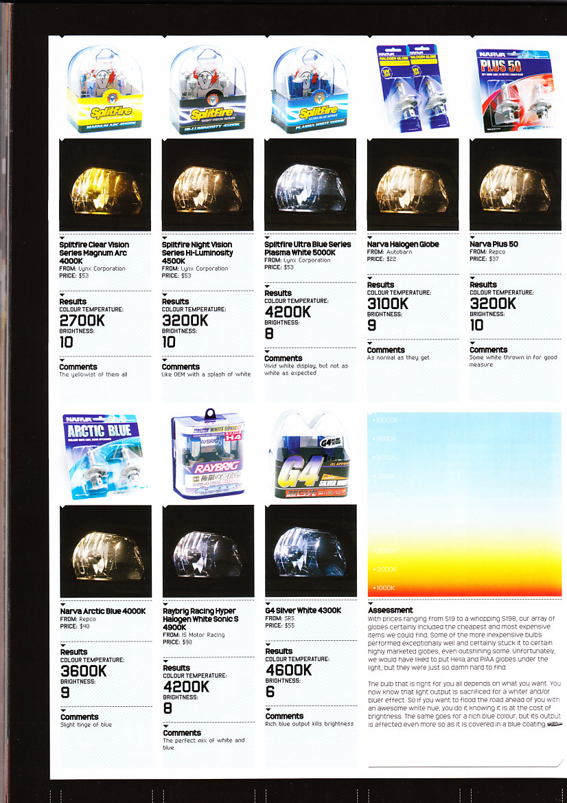

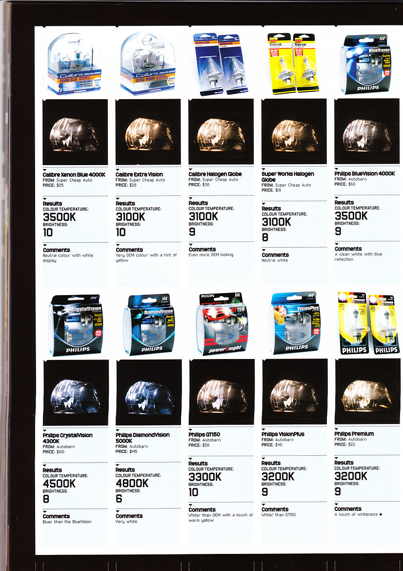

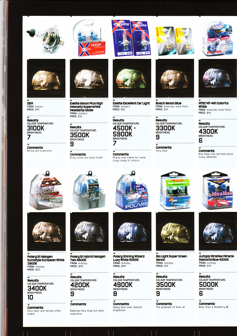

I was researching the Philips Xtreme Power bulbs and found this comparison of after market bulbs from 'Autosalon':
What it shows is the the less yellow (more white/blue or higher colour temperature) light you want to have is often sacrificed for brightness.
The Philips CrystalVision seem like the best compromise, but for value for money have a look at the results for the $25 Calibre Super Cheap Auto bulbs. :o
