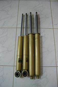

These arrived at my doorstep yesterday afternoon. Thanks SB!!
Koni FSD
post-2295-1215682752_thumb.jpgpost-2295-1215682773_thumb.jpgpost-2295-1215682725_thumb.jpg
In my little quest for a solution to increased handling with minimal disruption to daily comfort, I did a bit of looking around.
I've tried the following setups already
Stock - Quite good compared to the normal corollas, but still too much body roll and soft
Stock + King Lows - Only had a brief one week encounter, and didn't like the fact that any bumps on the road really unsettled the car
Tein Super Wagon- One word 'STIFF'
Since one of the shocks was leaking and the opposite end was a new shock (covered by insurance), my car was not at all sitting at a nice angle. So its another excuse to spend more money! :D
I narrowed it down to the following few options.
Koni Yellows
Koni Reds
Bilstein B8 Sprint
Monroe GT gas reflex
But the marketing on the Koni FSD's really got to me and I decided to give those a shot instead. Will be installing them on the weekend and hopefully it will be good. I'm tossing between standard springs or king lows. Will have to see if the shock is the same length as the stock ones, if its shorter then I'll go the lows if its the same then standard springs.

They set me back about $1300 and I thought that they would be a complete strut assembly, looks like i need to do some cutting and drilling on the existing housing to get them on.
Thai I am sorry mate I got told they were a complete assembly and NOT an insert. I checked it twice to make sure and got the same response both times. Hope this isn't a hassle for you. They do look good!!

UPDATE: I finally took it for a drive
I ended up fitting king spring lows with the Koni FSDs.
My first impression was a bit scary as the car pretty much felt like stock, so I had doubts as to whether or not this whole 'FSD' thing was a gimmick or not. The missus said that it feels more comfortable then the stock shocks and springs, granted that the stock shocks were on their way out, but still :o
But after taking the first corner at a slight 'brisk' speed, I can confirm that its a nice (big?) step up from stock. With my previous experience with lowered springs and stock shocks were very horrible, the car didn't feel that flat and bumps mid corner really unsettled the car.
With the FSDs the car handles like a dream in comparison, mid corner bumps are just bumps nothing more. The king springs and these shocks matched up quite well, although maybe eibach springs might be a wee bit better.
It feels more controlled then ever, it feels more flat going around the corner then my brothers liberty B4. Which is really saying something from a car that comes with a boxer engine, suspension is tuned by bilstein with a BMW M3 in sight.
But if we are compairing against coilovers, then I would say its a bit of hit and miss. Coilovers had pretty much no body roll and was really flat, but once you starting adding bumps mid corner then the FSD would encourage me to go faster. M
So I say for the vast majority of people out there with a daily driven car, FSD + Lowered springs maybe the way to go.
Overall, I am impressed and really happy with the end result to date. The only problem is getting over the fact that a car that can go pretty fast around corners feels nice and comfy on sydney roads, including parramatta road. Its a really strange feeling indeed.
