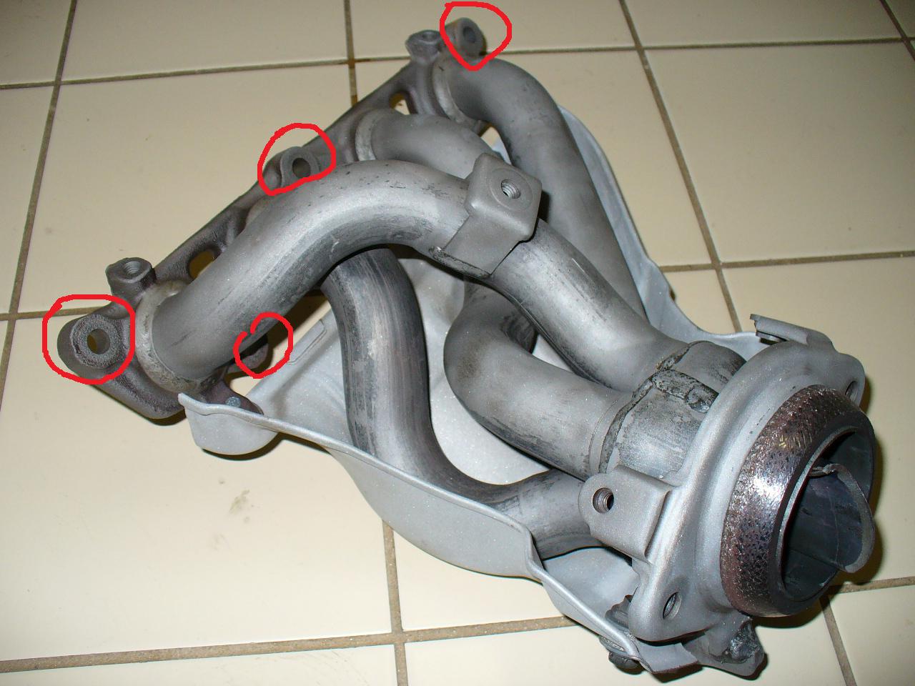

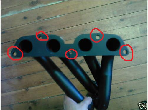

I dont think these headers/ extractors are made for 2zzge. i had a close look comparing the 2 but the 'bolts' on the Redback dont match the locations of the 'bolts' on the 2zzge
have a look and tell me what you guys think..
