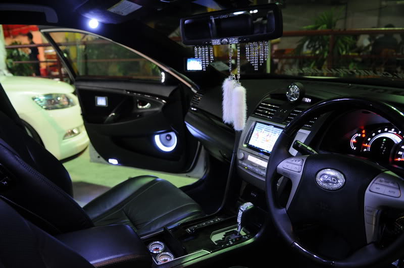

I've notice on a few of the Singapore/Thai Aurions that they have a carbon fibre look dash kit fitted does anyone know how to get hold of these?
Show some pics and you'll find answers
Around the gear shift kinda looks like carbon finish
very hard to tell with that picture. As for the carbon overlay, I'm not sure of any kits, but there are plenty of types of Carbon fibre lookalike film that you can apply yourself. See the "interior trim paint" thread for more information on this.
