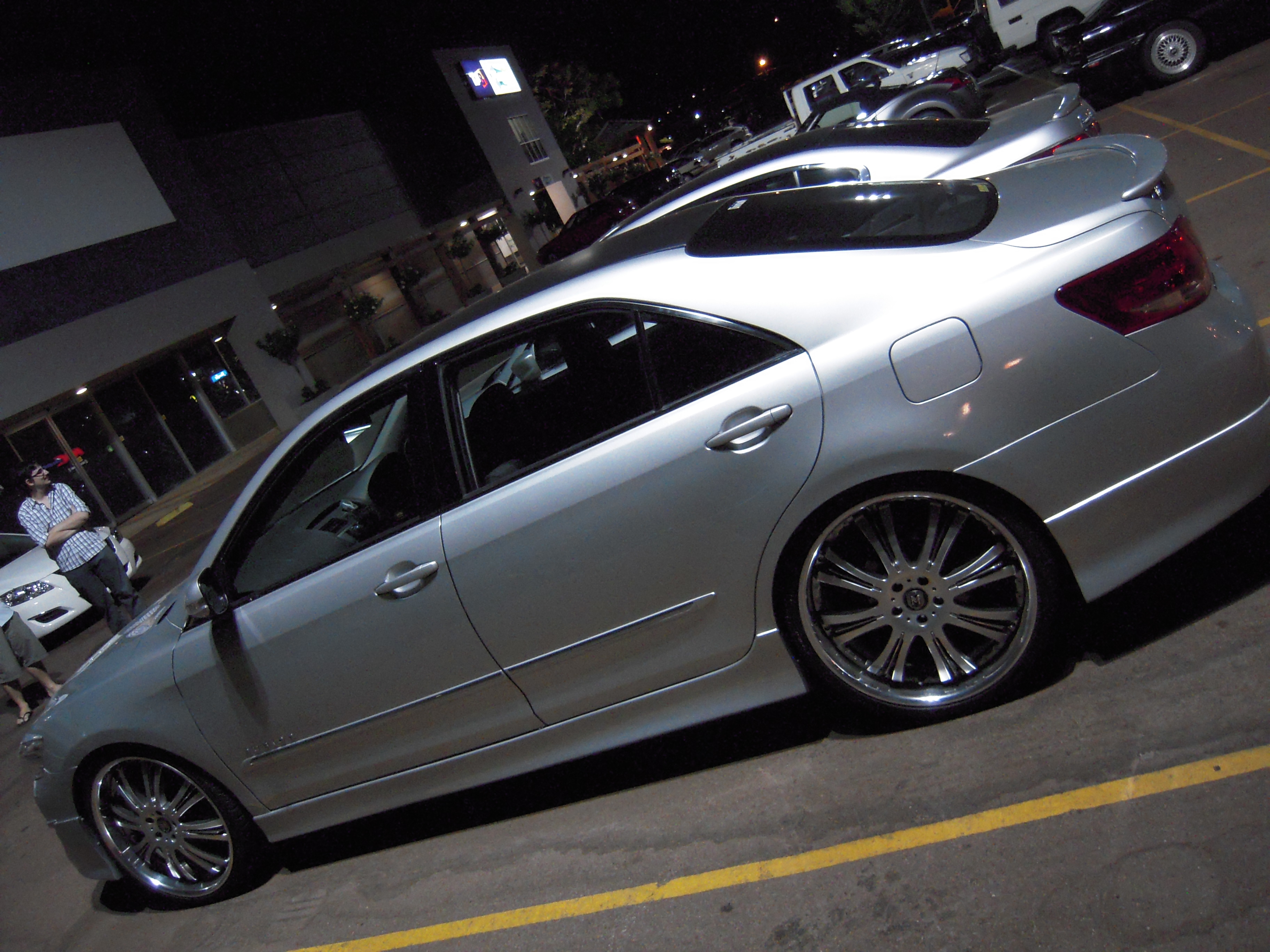

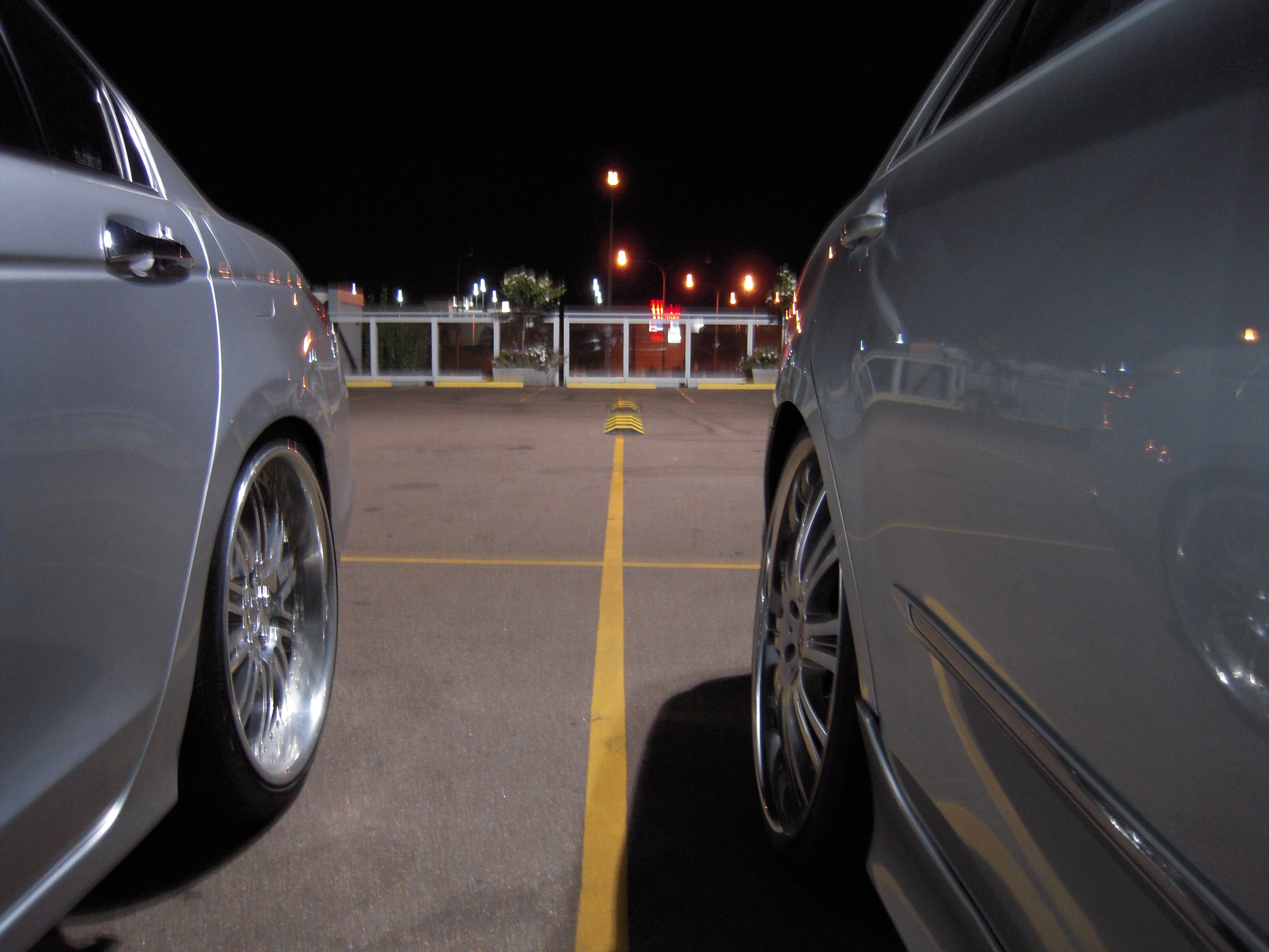

can I put 20" on my prodigy? say 1stkills old black and chrome rims.
someone here in perth has 22" rims and their mint but i wouldn't recommend it lol, unsure of width..
19" on left 22" on Right (also see slight camber on rear no camber on front)
post-21214-0-05601000-1306934850_thumb.j
22" Rims from LHS View
post-21214-0-30835200-1306934892_thumb.j
lol. thanks for the quick reply. it's not the looks or if it can fit etc I'm worried about. What I'm worried about is the legality of it, roadworthyness and insurance :huh:
in WA legality states you can go 3 rim sizes up from standard factory release....
My ATX comes with 16" so i can go maximum 19" again not sure if there is limit to width but 8 to 8.5 should be plenty without being to noticeable or cause you any issues with scrubbing!
If a copper pulls you over first things they check is, Rego, Licence, Tyres, Windscreen (cracks), seat belts and do the RBT most of the time now too!
