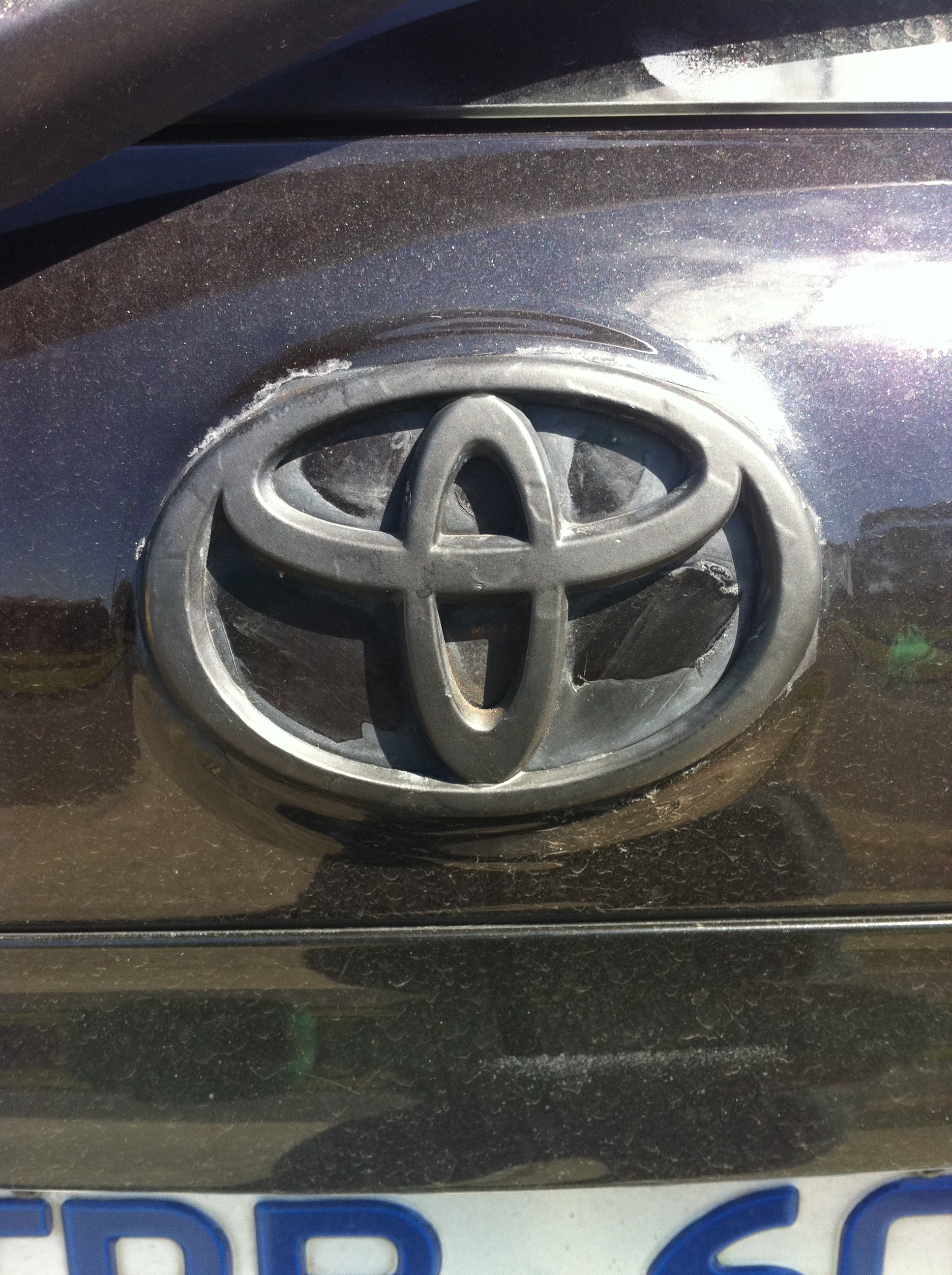

also this is what it looks like atm :angry:
post-18244-0-48145300-1317697985_thumb.j
Is that eating the paint and rusting?
nah i think thats the epoxy <_<
but ill double check again didnt notice that till now .

Just STOP...Stop and think, can I do this? To be honest I think you should take it to a professional before you do more damage.
Should of just bought a black Toyota camry emblem. If u wanna take that badge off, use a fishing line or dental floss. Then use 'De-Solv-it' citrus spray to remove the adhesive residue. Try using a bit of turps on a cloth to remove your overspray on the panel.

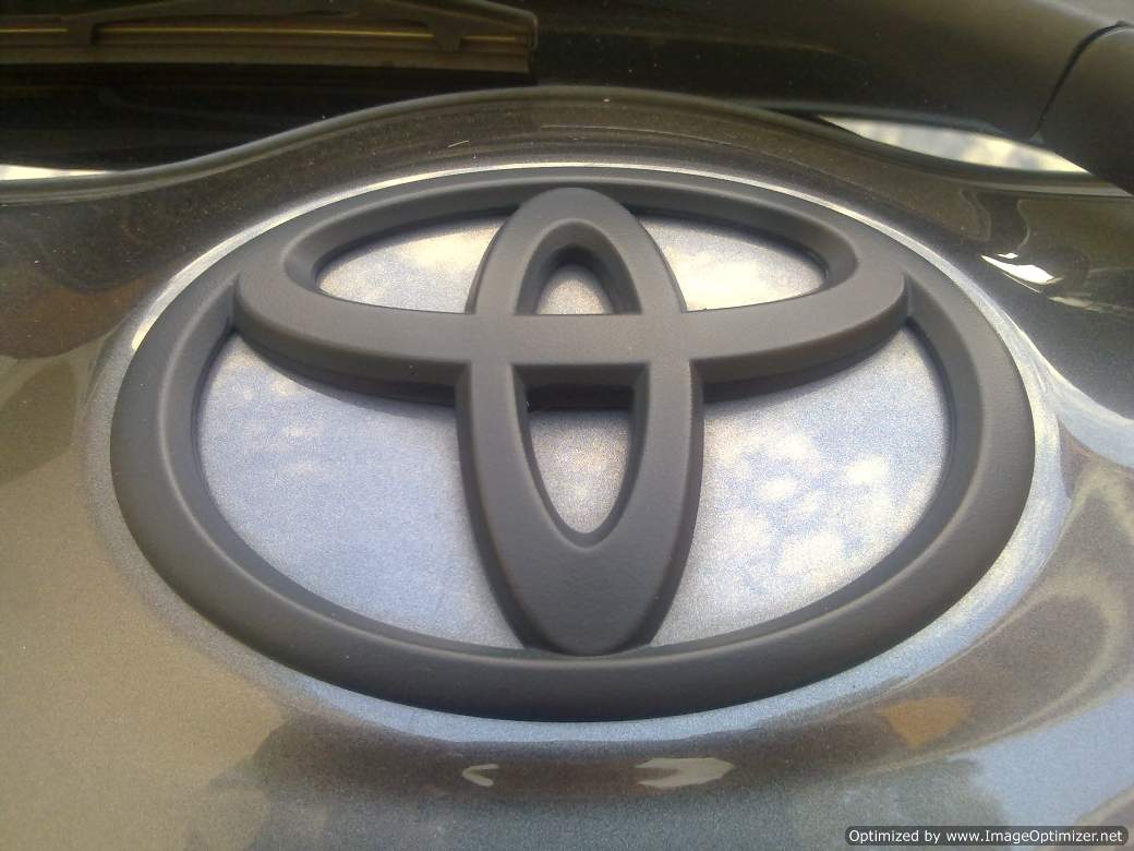

Heres how mine turned out.

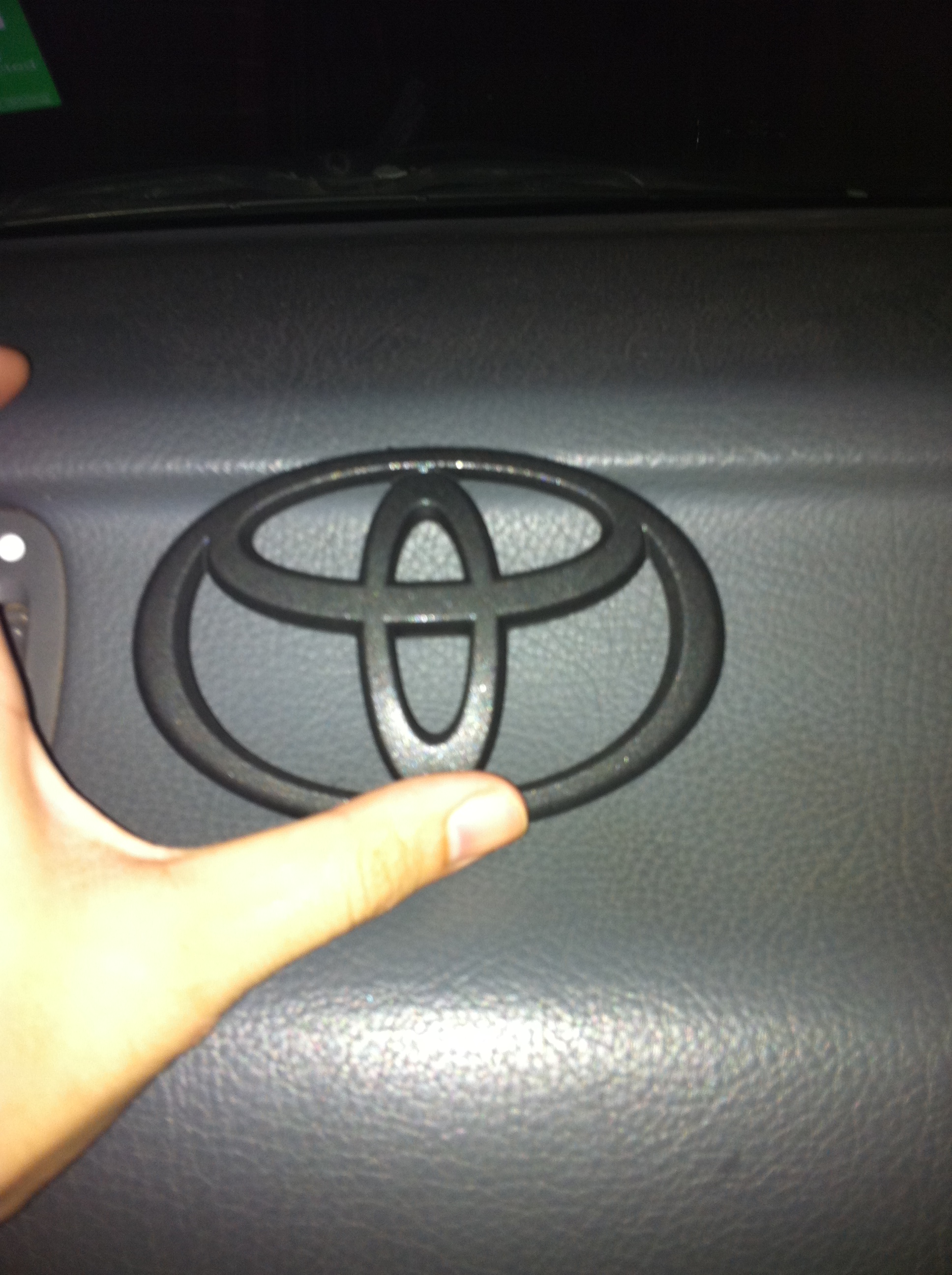

it looked like this before it got ruined. :(
