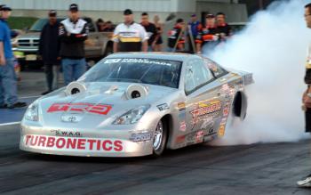

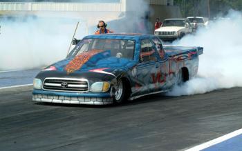

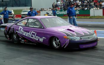

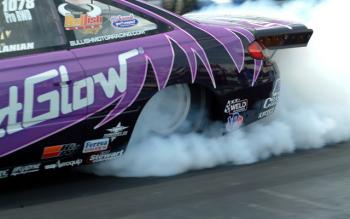

evl_50a dude... this is simple physics... torque is a measure force in ability to turn, and in launching, you have rubber flex to convert that torque to the rubber then to the ground.... hence bigger the wheels the thinner the rubber, hence more direct force to the ground will almost no rubber flex... and hence the reason why rubber on larger wheels run out faster...
you don't see any drag car running low profile tyres now do you?!
in terms of performce... off the mark you'll loose... but around the corner you'll probably do ok if you have good rubber, because for the same reason! you have less side wall roll on the tyre, hence you'll be able to "feel" everything... but more stress on your suspension...
have a think about it... i've owned 15s, 16s, and 17s... personally i think 16s are ideal for our car...
i'm not asking for any agreement here... but just by chance... the TRD Runx run 16s too... gee... makes you wonder why doesn't it?
why don't you go and borrow some and try both 16 and 18... then see for youself...
otherwise it'll be like trying to explain sex to a virgin!
peace
