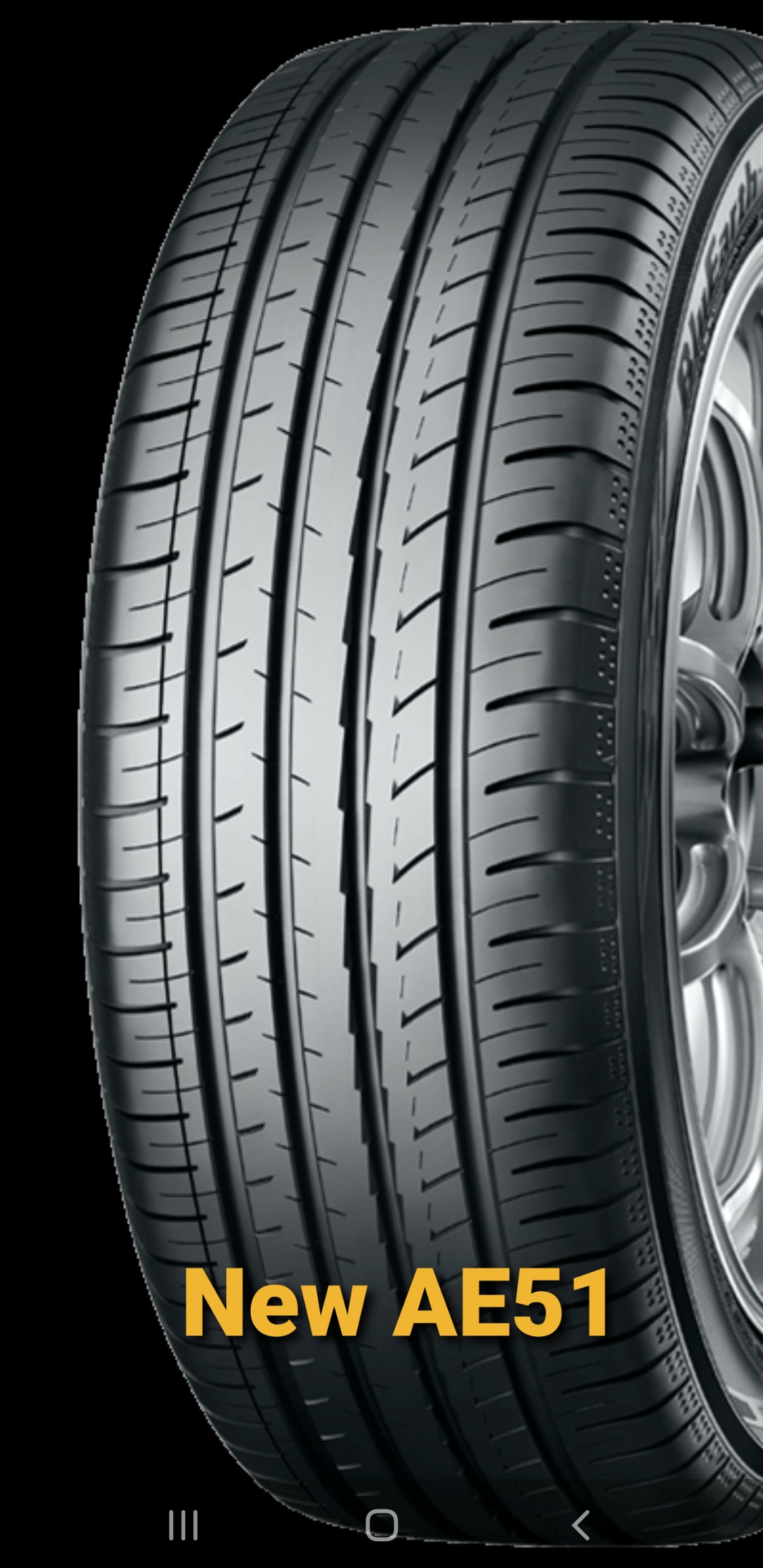

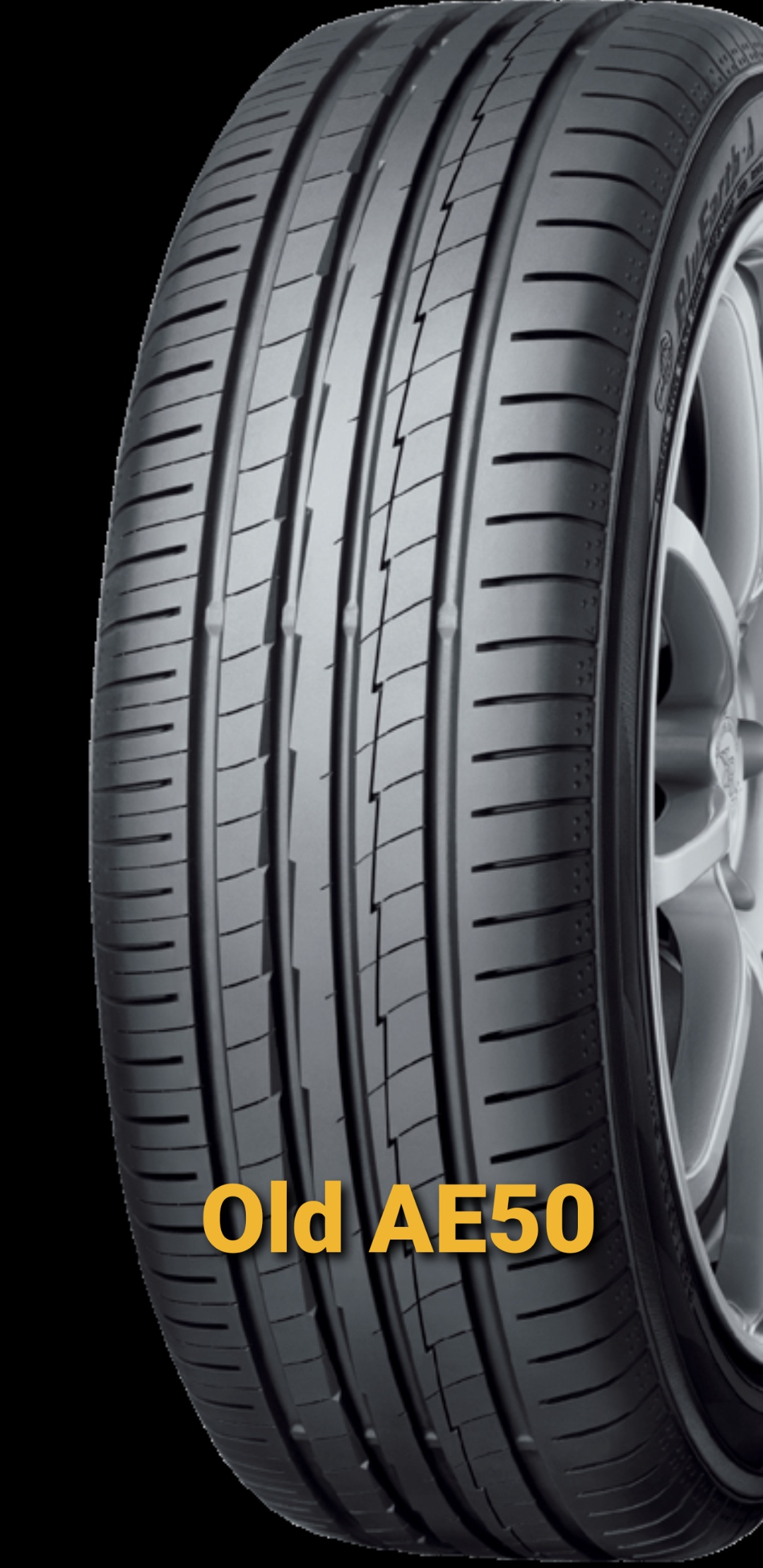

But they weren't a true eco tyre if that makes sense ?. Where the AE51 is aimed more at GT, handling, wet & dry stopping improvements, tread was redesigned for better water removal, grip, whilst being comfortable but not as soft compared to a Primacy 4. The latest 51's are worth a run.
Stiffer sidewalls too, thus improving handling somewhat.
I think the eco range is Yokohama BluEarth ES
BluEarth A AE50
New* BluEarth GT AE51
Still sold as seperate tyres but Yokohama have come a very long way recently. They've basically expanded the BluEarth range.
Pics below you can see the clear tread improvements (water, slits, etc)
