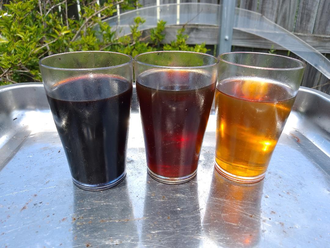

In my stash of products I had previously located a bottle of the Penrite Engine Flush so decided to use it for the engine oil change on the weekend. Odometer reading was 256,415 Kms and last oil change was 01.10.2023 for a road trip 10.10.2023 of 2500+ Kms.
Used engine oil [at operating temperature] and filter cartridge was replaced with a flushing oil and a cleaned used filter cartridge. The engine was idled for 10 minutes. This flushing oil and filter cartridge were then replaced with new cheap engine oil, the Penrite Engine Flush product and another cleaned used filter cartridge. Engine was idled again for 10 minutes. After this engine oil was emptied and a new oil filter cartridge fitted, I then poured more new cheap oil to help flush out any residual oil. Finally filled the engine with new quality full synthetic oil.
Photo shows 1. the used engine oil [done 3700 kms] 2. oil after the engine flush with the Penrite Flush product 3. New cheap oil poured through the engine.
Basically demonstrating that for an engine with known oil sludge that the Penrite Flush Product works. Still wondering if it is better than using diesel as a flushing agent.
Thanks Ashley for the update on Mr Sludgy, I feel personally yes a dedicated engine flush may be worth a try for a while mate. Looking at the end results it obviously did do a good job. Then again your battle over this time has also helped a lot to reduce that sludge you have been fighting so hard.
