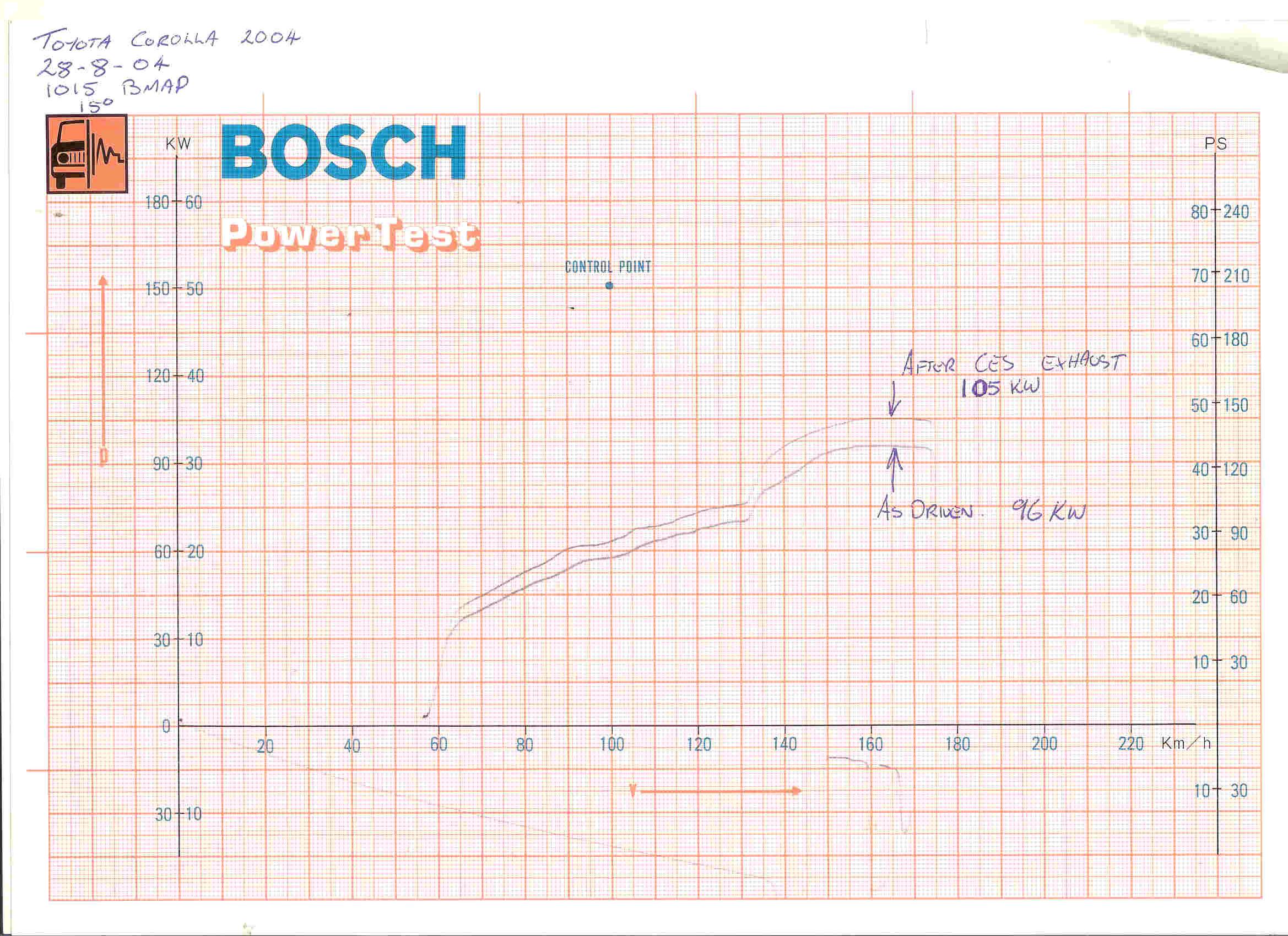

Here is a copy of the original comparison between the stock exhaust and the CES custom pipe. Runs were done in 4th.
Please note this dyno is noted to read 2kw or so lower that a dyno dynamics dyno (Same car ran 107kw in shootout mode).
Can post Dyno Dynamics sheet when it is scanned.

Thanks JC for posting this for me. AS you can see the CES system is a marked improvement from the word go, with increased power in the lower rev range as well as the marked improvement when lift kicks in. All in all, makes the car a lot nicer to drive with more responsiveness at light throttle as well as the car seems to cruise more effortlessly at higher speed. Just to let you know that production will begin on this system within the next 2 weeks depending on the workload at CES. Any other queries contact myself or call CES direct on 07 3200 2333.
