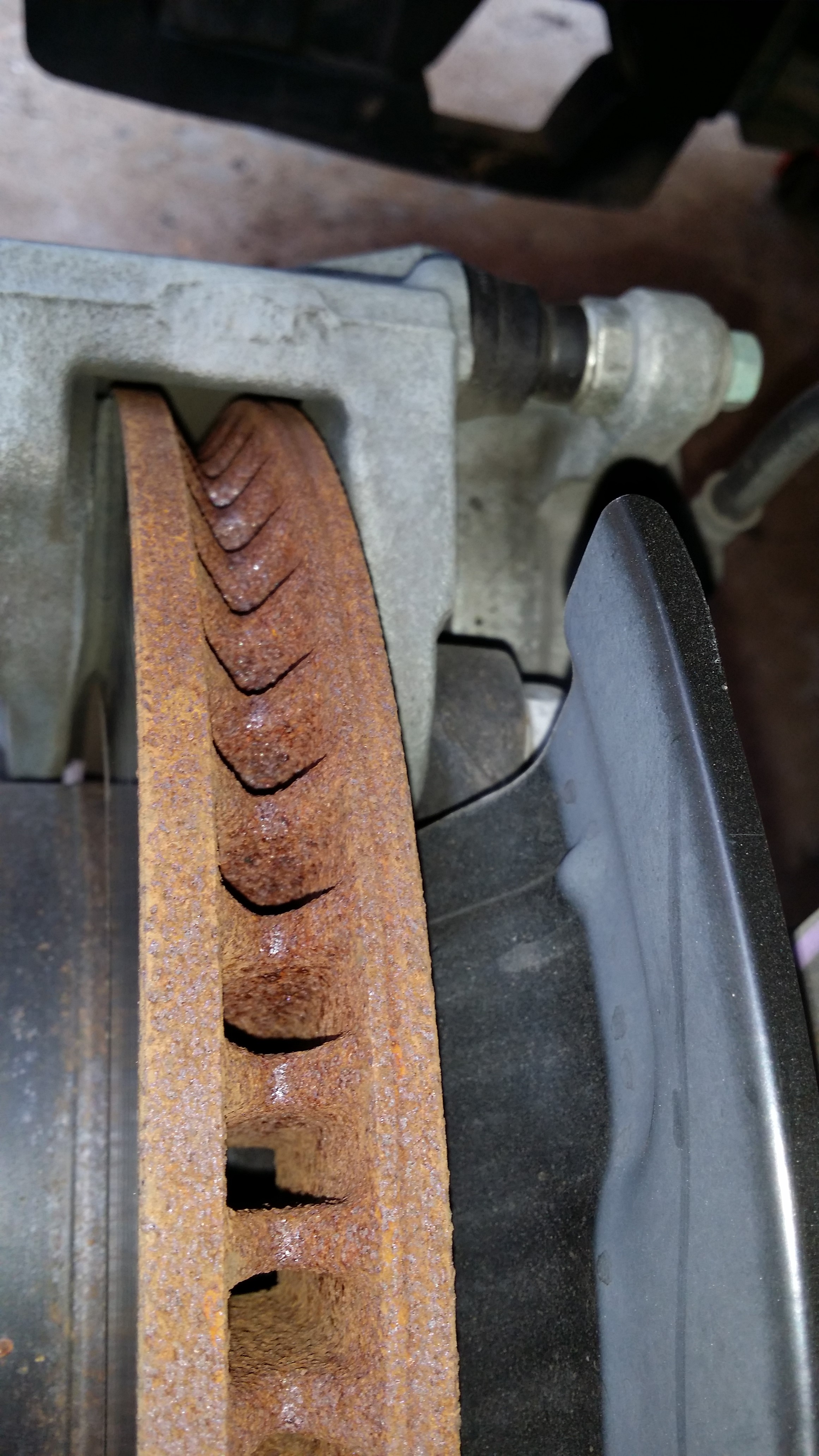

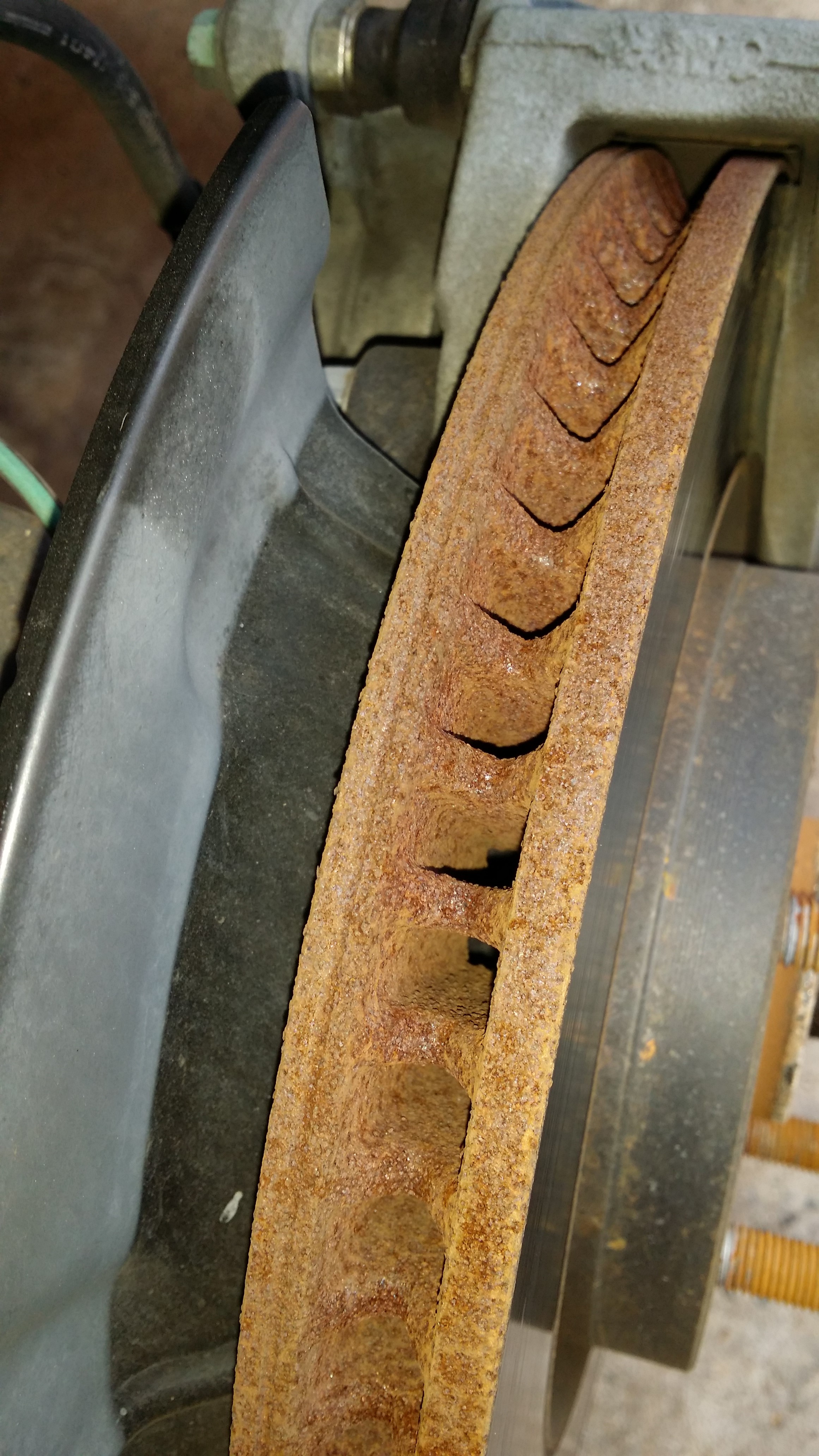

I recently inspected my front rotors/pads. Pads are almost due. I was also surprised at the wear of the right front disc though.
I don't have a decent set of verniers, but I suspect it's more than likely surpassed the minimum thickness.
Looks like I'll definately be up for some new rotors when I replace the pads.
The 1st pic is the passenger side.
The 2nd is the drivers side.
Recommend that you get a decent set of verniers first. You can also check with your fingernails if there is much of a lip on the outside of the rotor.
I bought replacement front rotors and brake pads for girlfriend's Yaris only to find when I measured the existing rotors that they were hardly worn. Mislead myself by just looking at the amount of heavy rust in the cooling vanes section and thinking that they were originals [ from 2007] and needed replacement.
Take a look at the caliper that is worn heavily on the inside. The slides or piston may be sticking.
The rotor 100% needs replacing. Replace as a pair.

I was somewhat surprised at the excessive wear of the inner side of the drivers rotor.
I plan to get two new rotors and pads. Hopefully the right caplier doesn't give me too much grief.
I might just remove the driver's caliper first and see if there is something sticking before I proceed with the new parts. If so, I can correct or replace the caliper if need be.

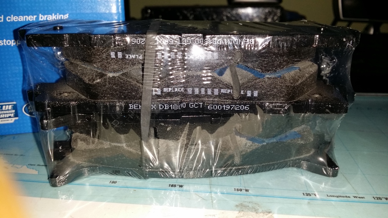

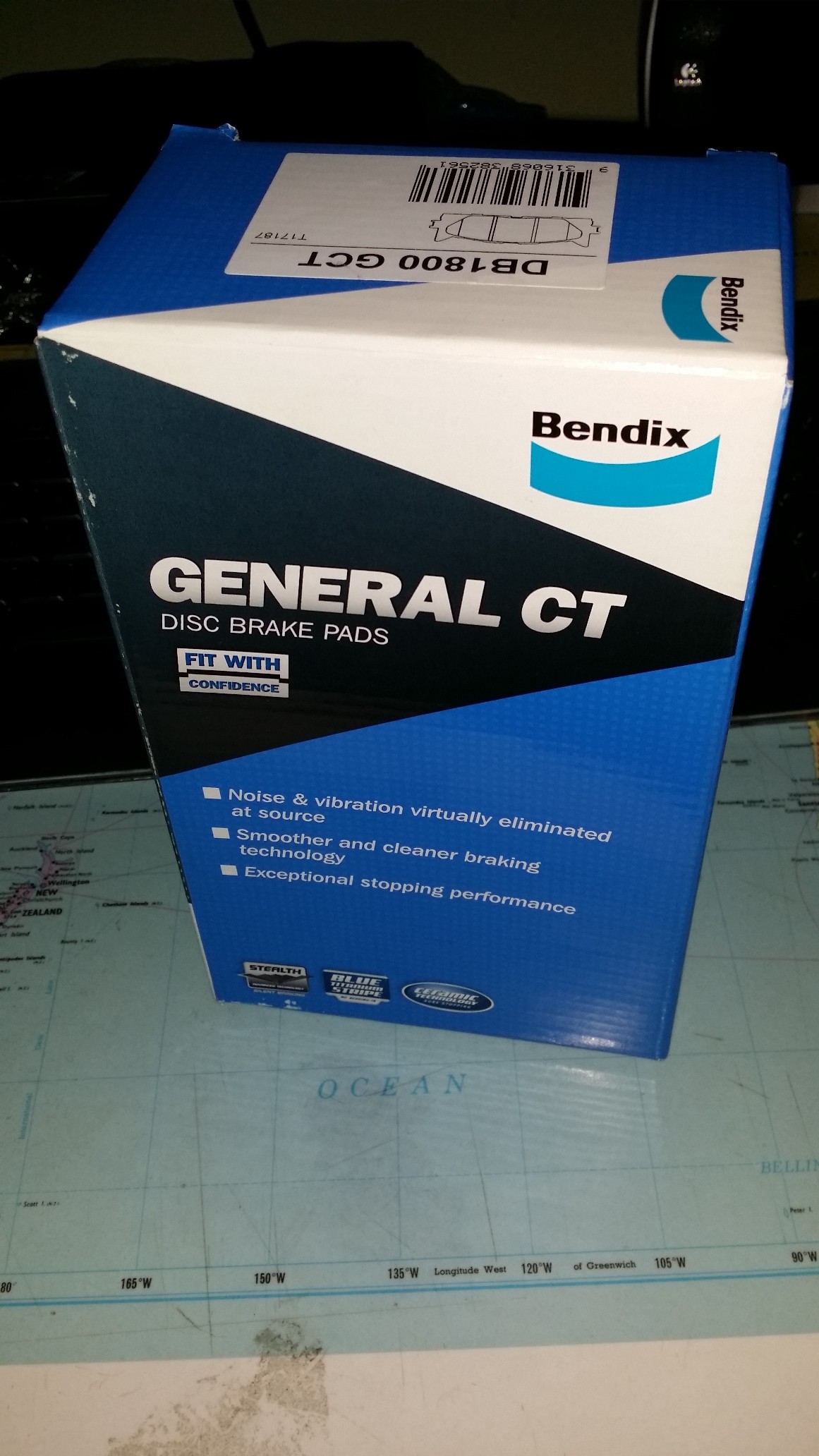

I just received my Bendix brake pad delivery. I settled on the GCT series Bendix. The HD series is a little overkill for what I require. We don't drive our Aurion hard to warrant higher spec rotors or pads.
Wow ! Ordered yesterday afternoon from nolan-australia off Ebay and accepted delivery about 10 minutes ago.
How's that for service.
All I need is the front rotors and I'll be in business for the full job.
I'll also be flushing the fluid while I'm at it too.
