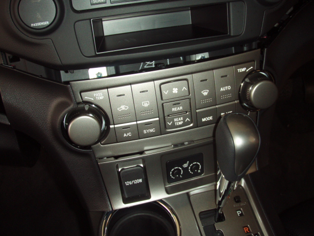

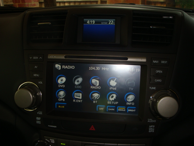

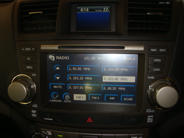

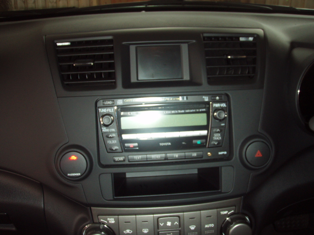

BEFORE
AFTER

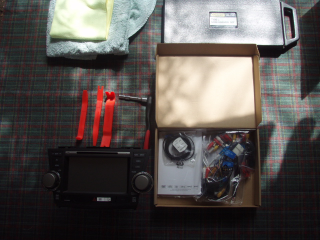

TOOLS
Here are the tools I used - the pry tools are important - the towel is to protect the centre console.
You should already have a 10mm socket with an extension and screwdrivers. (Note - no tools for electrical connections.) :D

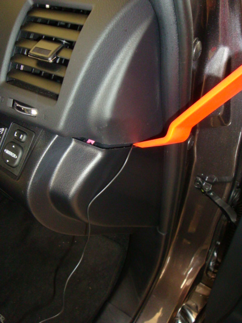

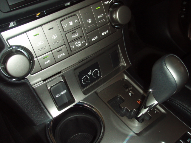

REMOVE CLIMATE CONTROL
You need the nylon pry bars and just keep working the dash panels on the side apart until the whole unit disengages form the dash.
You also need to have the gear lever in drive to remove the climate control unit.
Remove the electrical connection/plugs for the climate control and take out the unit.

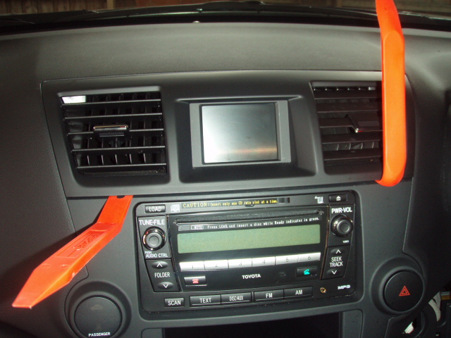

REMOVE VENTS
The vents take a fair bit of steady firm prying to disengage them from the dash.

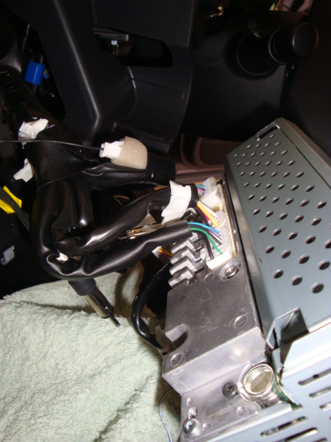

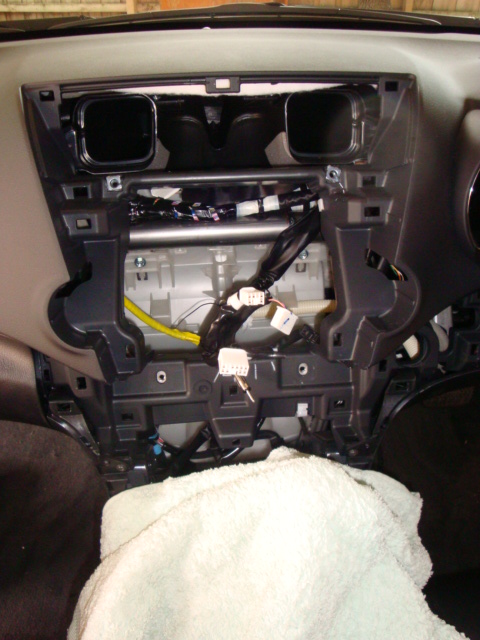

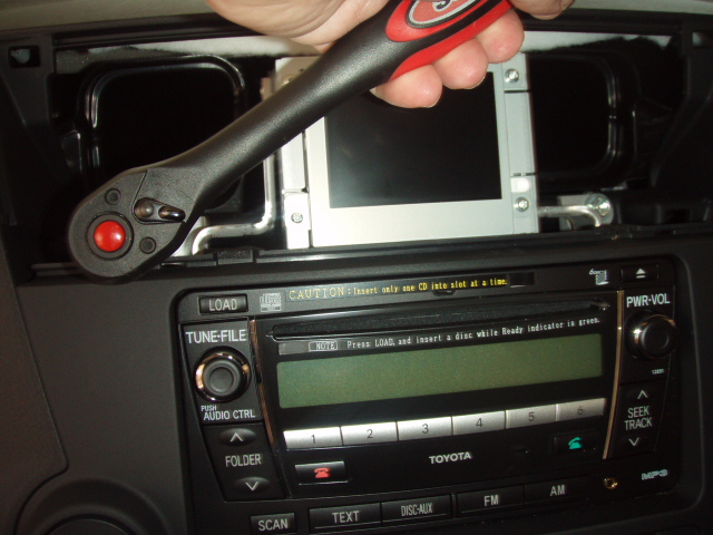

REMOVE OEM STEREO
Use the 10mm socket drive to remove the four bolts holding in the OEM unit.
The trip computer screen comes out with the stereo unit.

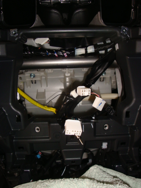

Note and remove the connections on the rear. There were two coaxial aerial connections, but only the larger one was connected to the stereo. :huh:
Note the old towel covering the gear lever and centre console.
Note the three connectors left - the old stereo surround has a splitter from the separate hazard and seatbelt warning light and leaves only one plug which reconnects to the new hazard switch assembly.

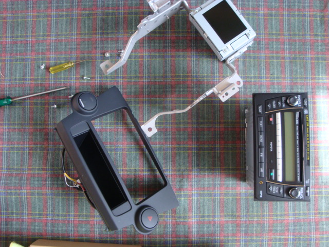

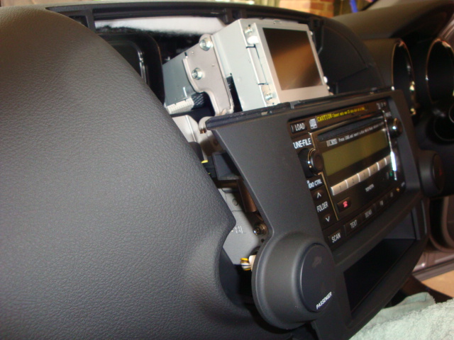

REMOVE BRACKET
Unscrew the bracket - note the extra tabs on the side of the bracket which are used to hold steady the old stereo surround - these need to be removed once the bracket is screwed onto the fly audio unit. Just repeatedly bend and fatigue the metal to break them off. (This step is not in the Fly Audio guide).

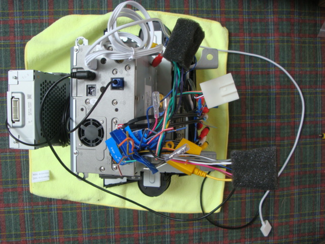

TEST ALL THE NEW ADAPTORS
Plug in all the supplied adaptors so you know where they go. (I didn't use them all because I don't intend to install a separate CD stacker - its not needed once you have the iPod function.)
Remove the travel screws in the new unit and reattach the bracket including the trip computer screen.

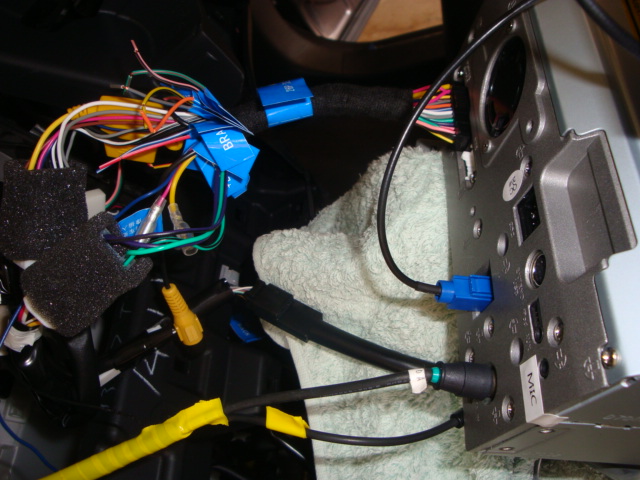

CONNECT THE NEW UNIT
Connect the supplied adaptors to the harness and the hazard switch assembly.
The GPS aerial (blue plug) is magnetic and just sits on top of the trip computer screen - the plastic dash doesn't interfere with the signal.

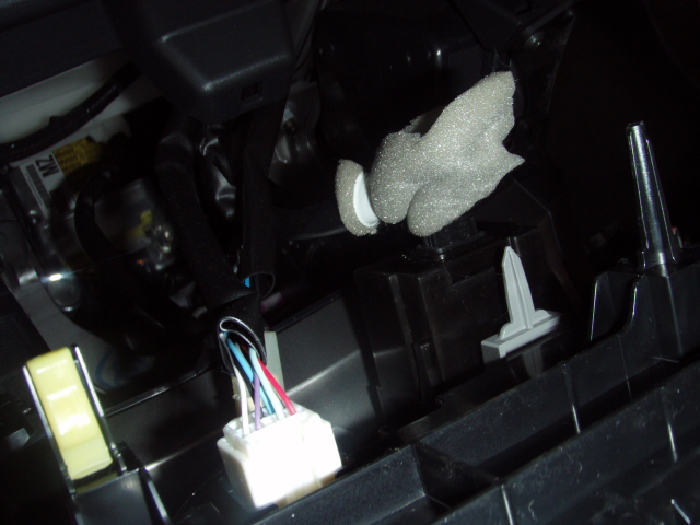

Don't forget the phone mic (like I did :( ) just leave it hanging down in the drivers side footwell for installation later.

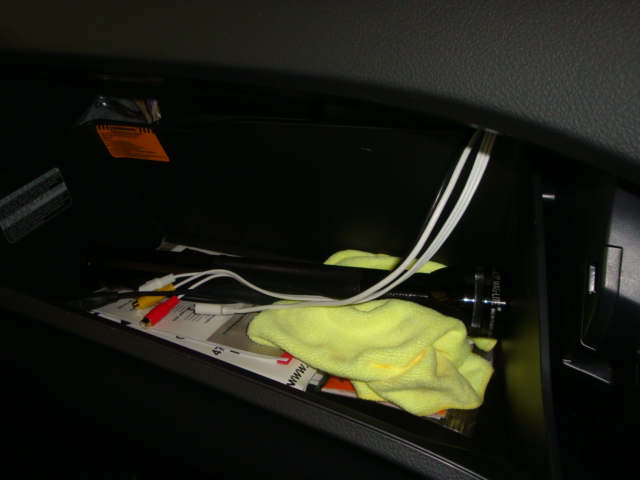

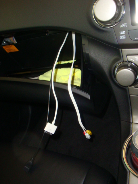

Run the iPod and Aux cables from the glove box into the back of the new unit.

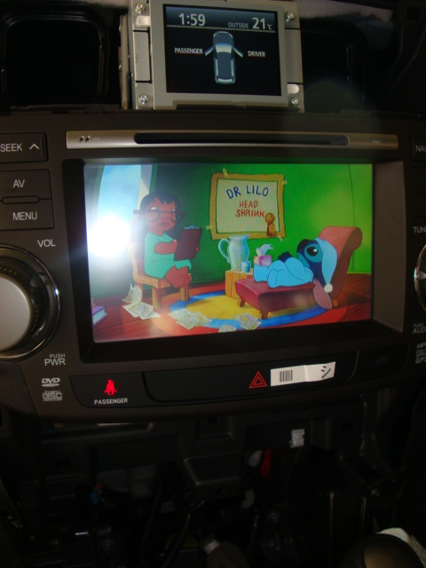

TEST THE UNIT
Test the unit before reinstalling dash panels etc.
I asked my eight-year-old daughter to get me a DVD to test - she got Lilo & Stich. :)
I also tested the radio works to make sure the aerial was connected.

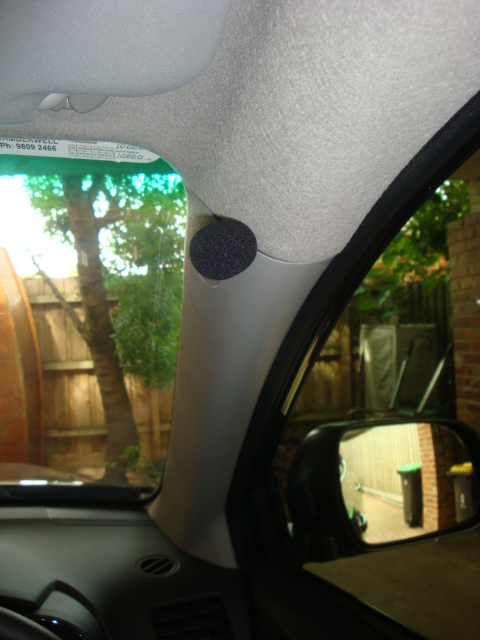

INSTALL PHONE MIC
Run the microphone wire through the gap between the upper and lower dash panels and up the door rubber to the top of the front pillar cover.
That's it - all done - simple really - just plug and play. ;)

Thanks for the install info Hado, very informative and great photos too.
I agree with Kesawi though - the microphone does look big. How does it look if you take the foam cover off? Does it use a standard 3.5mm mic?
Gutsy effort though and thanks for sharing!
Great write up.
That microphone looks huge!
Did you hook up the reverse camera?
I think it is just due to the perspective of the photo - but I have removed the foam cover and it is just a normal mic.

Surprising that it doesn't have a "proper" ipod connector?
I does have a proper iPod connector. I am running an old first gen 4GB Nano from it.
Here is a better photo.
It also has the AUX player connector (red/white/yellow RCA) and a USB connector.
I haven't tried an auxiliary player - but I have tried a USB stick/drive which works fine. The AUX option runs like a computer folder menu - the iPod is much more integrated - showing song title, artist and album. It is also searchable by these tags and runs playlists just like an iPod does.
I'd like to try a portable USB disk drive - one that doesn't need a separate power cord - to see if I can get a lot more storage for DVD rips - DivX movies etc..
Thanks for that - couldn't see it in the original pics!
