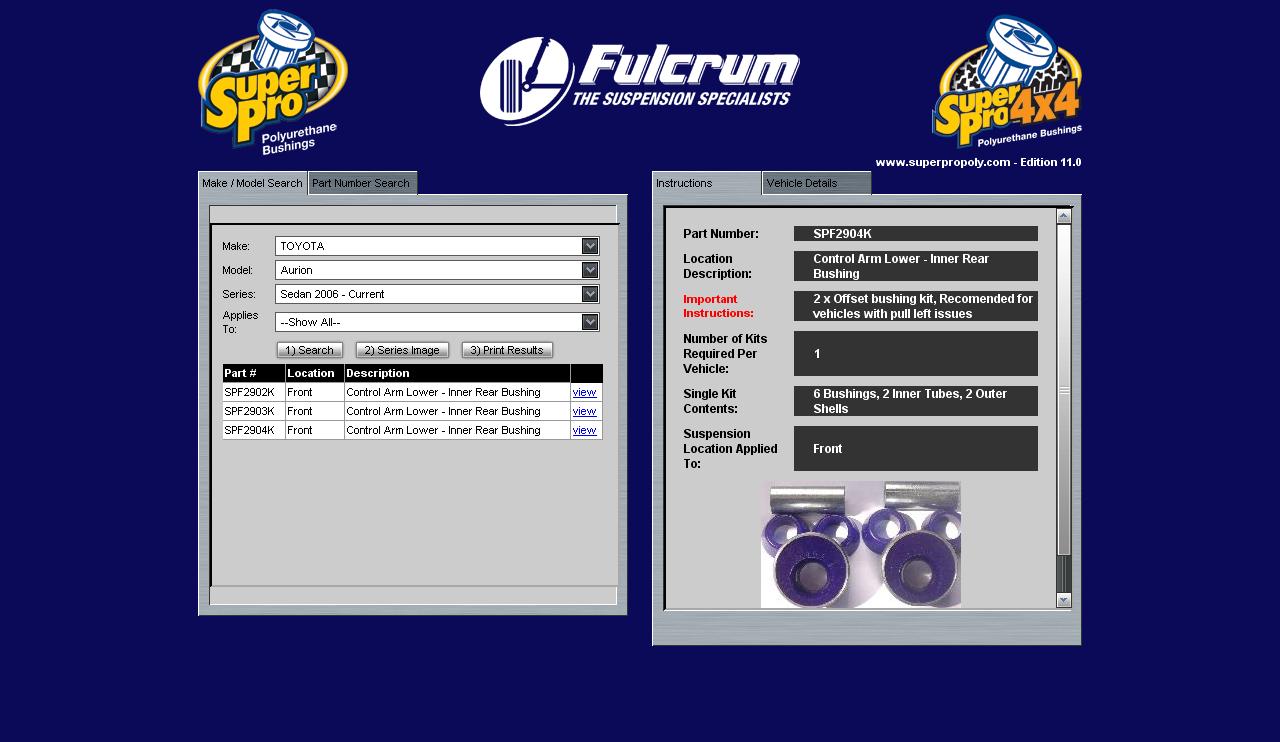

TOYOTA HAS PROBLEM. THIS PART kit - SPF2904K, IS FROM Fulcrum. AS THIS SAME PART IS FITTED IN MY CAR BY Fulcrum AND MY CAR IS 100% OK AS THEY ALSO DID A W/A. TOYOTA IS NOW USEING THIS PART BUT THEY DO NOT KNOW HOW TO DO A CORRECT W/A.
EVEY ONE MUST E-MAIL TO TOYOTA ABOUT THIS PROBLEM AND HOPE THEY WILL FIX THIS PROBLEM.
WHEN I GOT MY CAR IN 2007 I HAD THE SAME PROBLEM AND TOYOTA SAID THIS IS NORMAL. SO I TOOK MY CAR TO RACQ AND THEY SAID THERE IS A W/A PROBLEM CAUSING IT TO PULL TO THE LEFT. I TOOK THIS LETTER TO TOYOTA AND THEY SAID YOU CAR IS OK.
SO I TOOK MY CAR BACK TO THE PLACE WHERE I BOUGHT THE CAR, THEY WHERE VERY HELP FULL AND THEY PAID Fulcrum TO GET MY CAR FIXED. TOYOTA WAS NOT HELP FULL AT ALL.
Are you saying that Toyota now stock the appropriate part to correct the problem? Even if it does involve going elsewhere for a true wheel alignment, I wouldn't mind if it meant that I got the corrected part under warranty. Would something like that be covered under warranty?
Your Toyota dealer will only fix this problem if you keep going back to them. Tell them what part number to put in - see my previous post. The only problem is that they don't know the proper wheel alignment specs. I would recommend going to Fulcrum for this.

I bought a camber/caster gauge for about $400 and measured the wheel alignment on my 2007 ZR6.
After going to Toyota for 3 wheel alignment within 1 yr and they did not fix the problem.
FRONT (old setting)
LEFT RIGHT
Caster = +3.50 DEG Caster = +3.50 DEG
Camber = -1.50 DEG Camber = -1.50 DEG
Did not measure toe
REAR
LEFT RIGHT
Camber = -2.00 DEG Camber = -2.00 DEG
Did not measure toe.
The measurement I took was good if the car was travelling on a dead flat road then the car will not pull to either side. However the roads in Australia are sloped down to the left to allow rain to drain. It’s this slop (road camber) that causes the aurion to pull to the left. To compensate for the slop of the road, you can adjust camber using camber bolts or caster using the part from Fulcrum as mention by other in this forum (both of these methods have been implemented since the invention of independent suspension). I decided to use 17mm camber bolts as it was easy to install (bolts cost me $110) to reduce the camber on the front right by 0.50 DEG.
FRONT (new setting)
LEFT RIGHT
Camber = -1.50 DEG Camber = -1.00 DEG
Did not measure toe (left as factory spec) range should be within -0.10 to -0.250 DEG.
REAR (the same as old)
Since there is more negative camber on the left it pushed the car up the slop of the road counteracting the pull to the left resulting in the car travelling straight.
Using offset bushing to offset caster your wheel alignment spec will be:
FRONT (new setting)
LEFT RIGHT
Caster = +4.00 DEG Caster = +3.00 DEG
Since there is positive caster on the left it pushed the car up the slop of the road counteracting the pull to the left resulting in the car travelling straight.
Caster adjustment require a toe adjustment when finish, while camber does not.
Now, why Toyota did not do this in the first place I will never know. Since the aurion is sold worldwide (badge as Camry V6 in the US) the setting I have used on my car will not work as they drive on the wrong, oops I mean on the right side of the road will cause the car to pull to the right and since the road is sloped to the right. Right hand drive cars need adjustment to compensate a left slop in the road and a left hand drive car need adjustment to compensate for a right slop in the road. Toyota must have seen that it was cheaper to design one car for the world use rather then a left hand model and a right hand model. It also up to the wheel alignment technician, a skilled person will know how to adjust the car right. Even a Toyota technician can be a bad one.
HOPE THIS WILL HELP - I HAVE FIXED MY CAR PULL ISSUE AND IM GETTING 9.6L/100km FUEL ECONOMY. BEFORE THE FIX I WAS USING 11L/100km. CITY FREEWAY COMBINED
