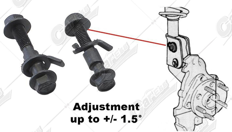

You can adjust the front camber a little by loosening the front hub bolts, if not enough then you would have to replace them to give you the amount of neg camber you after, perhaps 0.25-0.5deg ?
I love to learn how to be able to do this but you need specialised tools wouldn't you ? Wheel alignments are getting more expensive these days. Between $60 and $75 now.

Attached is a Whiteline camber bolt fitting guide. Following diagram shows the placement.
I have also added 17mm front camber bolts to my eBay WatchList.  Already have the 15mm camber bolts to fit the Aurion rear.
