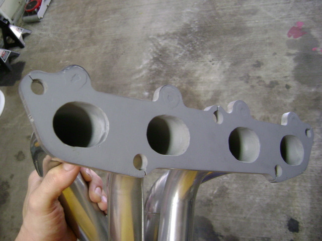

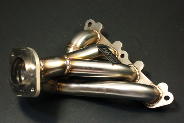

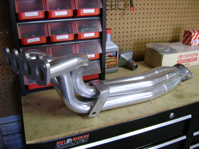

I have been doing some research on headers availible for our 2ZZGE corollas, thought I would just post up what I have found including pictures for anyone that is interested.
TRD: Similar to the stock headers, just with longer primary pipes. Gains expected in top end power
CONE: Im not to sure about these. Im looking at rollamods for answers in regards to these headers, I think they are a 4-1 design from the picture.
CES: These items are just the stock headers ported and polished with HPC coat. Gains expected in low to mid range power
Just a quick question to those with the TRD headers, is that little square hole in the headers for air injection?? I cannot see one in the C-one headers.
If someone has a picture of the CES headers please post them up so I can add it. I cannot find the old CES thread with the pictures.

the little 'square hole' you describe is for the heat shield I believe.
The CES ones don't look that exciting, they look exactly the same as the TRD and the standard ones.

CES are stock headers ported and HPC coated. Gains are in the low to mid range and will also make a difference top end.
TRD headers. Identical to stock with slightly larger diameter primary pipes. Gains are minimual and prolly more top end than anywhere else in the rev range. Best to used with the TRD stroker kit or internal engine work(cams, porting etc etc) But for price CES option is good bang for buck.

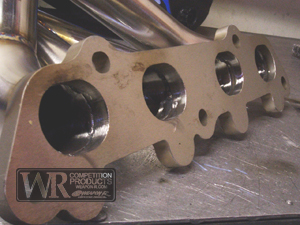

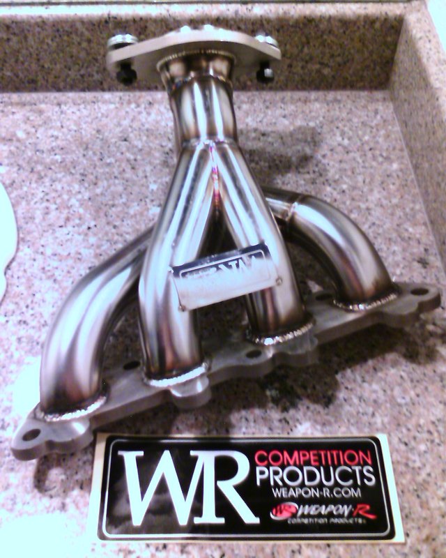

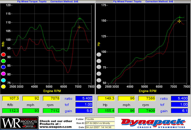

Well I was looking for more headers and found that Weapon R has released a new STREET header for the 2zz, which actually gives very good gains.
I have also attached a dyno sheet, it shows a healthy increase in the midrange. Do not mistake this for the Weapon R Race headers which have been shown to lose top end power. I got this from newcelica.org, everyone there was quite skeptical, but a customer car was dynoed and proven gains seen. The dyno shows only up to 7800rpm, but this is due to the test celica car being rev limited. Different year model celicas in the US have differnt rev limits, like in AUS. I would like to see an independent dyno done not one done by Weapon R, just to make 100% sure that this actually works unlike their crappy race header.
This header is also on special for US$175 plus shipping might be just over US$300. Damn looks pretty bang for buck.

As for weapon R headers they showed dyno sheets of their "race" headers making gains as well but when independently tested nobody really got the same results.....

Yeah the Weapon R street headers are a unique design, like you silvabullit I question if they actually perform.

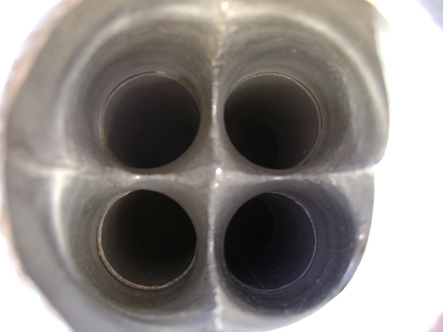

Are our stock headers are 4-2-1? They look like 4-1.
The Weapon R usually give midrange at the expense of top end. They are cheap for a reason. Just go with ported stock manifold if money if tight.
The stock headers are 4-2-1. Where you see the pipes collect at the flange the mid pipe section is actually divided into 2 sections. So while it looks like one big pipe it is actually 2 half pipes inside that re fed each by 2 cylinders. It is an effective way to do it and also where space is at a premuim. the divider in the mid pipe is about 500 mm odd long.
So while the actual headers look like 4 -1 they are paired to feed each side of the divided section in the mid pipe.

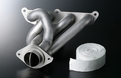

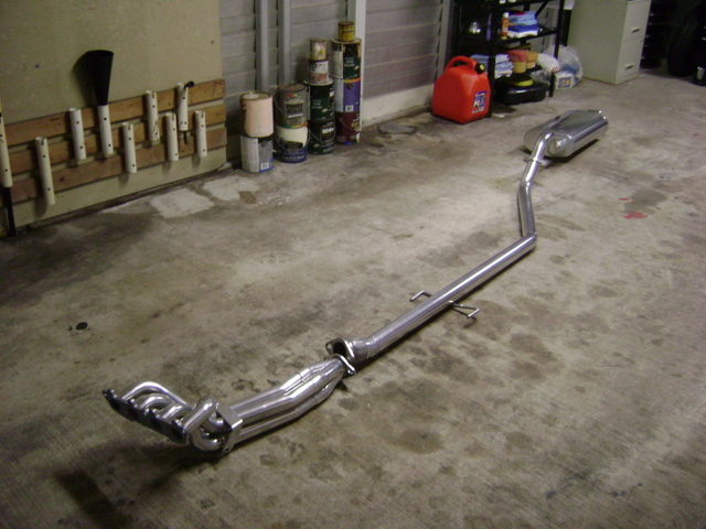

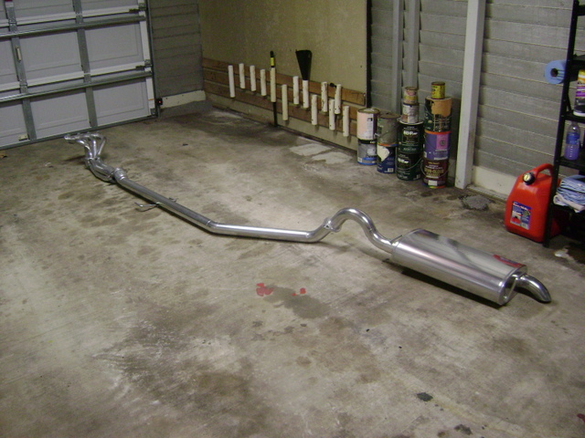

OMG these are sex and quality work from PPE in America. The pipe layout looks identical to our corollas, so most likely will fit our sportivos.
