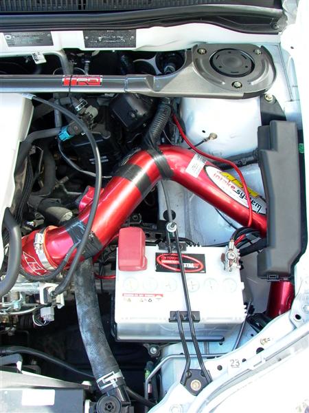

The AFM is on the back of the pipe basically directly opposite the positive terminal of the battery in the picture.
You can also see the Blue clip from the VSV controller just behind it there also.
There is a bracket that came with the kit to position the VSV on but the bracket to locate it on is connected to the 'lower VSV' which is only on the Matrix and not on our cars, so at the moment it is just hanging there until I can fabricate something.
Sorry Bill, it's staying chrome, just the way I like it... :P it looks nice and clean in chrome I feel.

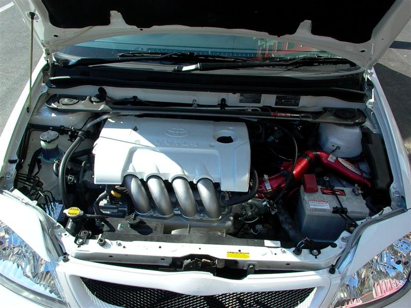

Here are photos of how the AEM intake looks in my car. Forgive the black tape that is used. Never got down to fixing it up neatly.
E-Gene - I've noticed mine is a slightly different design to yours and Danz?? There is a less dramatic elbow on it. The silicon join also fitted over the throttle body with no problems at all. I think there may have been a minor re-design cos mine fit beautifully.
