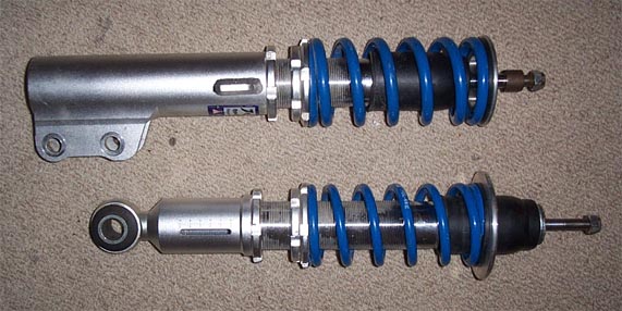

Pippy sourced a set for me, and I got it 4 weeks ago. Itching to fit the coilover, exams are coming and no time to spare. I finally able to get the coilover in last night, so here is some review.
The spring rate is rather weird, it is 8kg front with 4kg rear, looks like its a recipe for king of understeer. Its also non adjustable damper, so I can only hope that the damper and the spring rate are well-matched. But nevermind that, its serves to ride on street, can't go understeer with 60km/h turn.

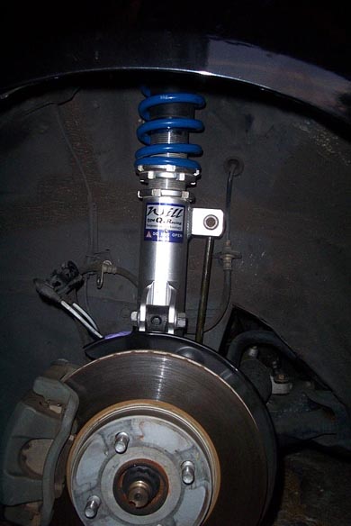

Installing is easy, as long as you have the tools and been looking at DIY guides. I am affraid that the ride will be harsh, being 8kg at front. I lowered the suspension to the max, and thanks to 2 way height adjustable, I do not need to lower the suspension from the spring perch, just raise the suspension body and that lowers the suspension without the sacrifice of suspension stroke. The rear is perfect, no gap whatsoever, but the front, hmmmmm, still 2 fingers gap, and Dr Danz don't like that, so new linear spring with custom height has to be sourced very soon.

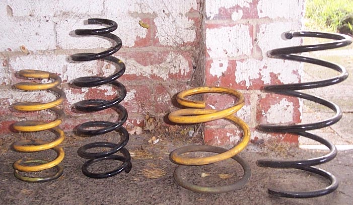

And here are some pictures, including my old-timer, Ghetto Low Kings Springs.
Thanks man, and since you're the pro here, what I intend to do is get lowering spring so it allow me to raise the sprng perch and get more thread for the suspension body to go up.
I guess that should be fine coz the srut travel don't suffer much?
hahaah that pic, i remember! i was staring and staring at it b4 i my stivo got delivered :lol:
It looks not much diff on distance, but the front is higher. Nevermind that for now, quite broke to spend on set of lower springs, camber has to go in to fix the allignment too.

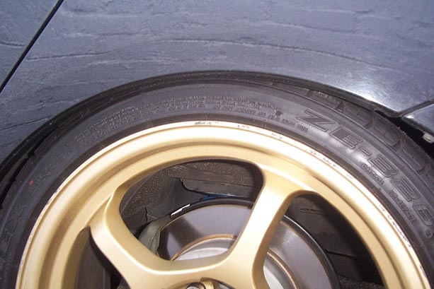

But hey, at least I don't rub when I thunders through corners at Mach 4.
