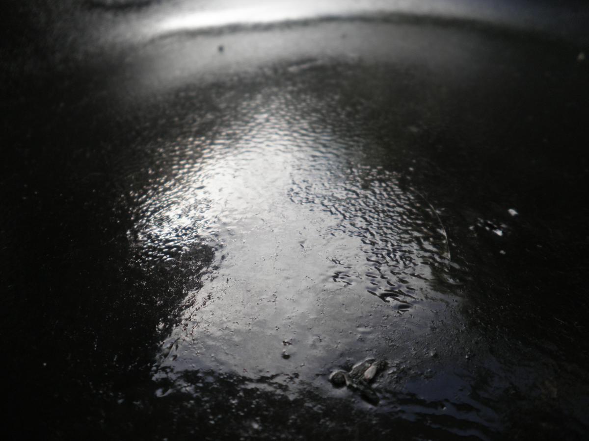

DeafDave, doesn't matter if it has a dash cover or not. It still melts. It is a known manufacturing fault. Warranty does not apply to manufacturing faults. Love to hear from anyone else with a problem. Just as a point, also, mine only started in the last twelve months and it is a 2008, so early days yet for your car.
Edited by HelenC
I have the same sticky dashboard problem, I own a Toyota Aurion Prodigy 2009 where the dashboard is so sticky, it looks like it is melting. I feel that this is not a warranty issue but a manufacturing issue. I hope this does go to A Current Affair I feel they will be surprised at the response they will receive. Its about time Toyota stepped forward and took responsibility for this like they did in America. I feel that because America have a larger population which means a larger volume of voices this is why Toyota have replaced the dashboards, Just because we are a smaller nation doesn't mean we don't have voices so what is good for one country should be good for another.
Toyota have had such a great reputation for such a long time I would hate to thing that people are going to thing twice about buying a Toyota because they will not take responsibility of a manufacturing fault.
From what I have heard so far, it seems to be limited to roughly 2006 to 2009 inclusive, and it doesn't start immediately. It has taken about three years on most cars to get to the really sticky shiny stage, but then it goes downhill fast and starts disintegrating. There are photos on the melting dashboard page on FB that are just awful, worse than my car! Very disappointing, but I am not going to give up on this. We bought quality cars with hard earned money, in good faith, from a reputable company. My Aurion has been mechanically brilliant, but the dash is a cesspit.

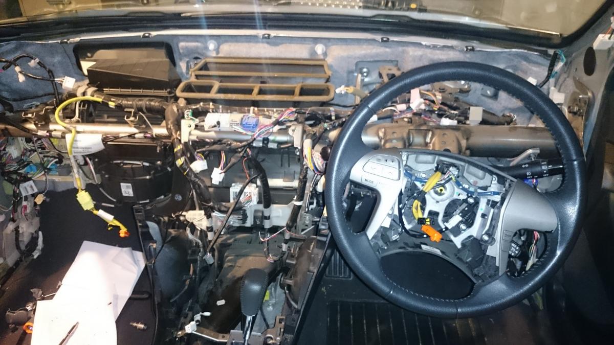

I've completely removed the dash to try to clean it, this didn't make much difference. The process of getting it out just causes more damage on the already soft surface. I also plasti-dipped it but I wasn't happy with the result so removed it, and it's not a long term solution. I even considered wrapping it. So I'm now in the market for a dash mat to cover the ugly thing, out of sight, out of mind...sort of.
As a side note, if anyone is interested in what's under the dash:
post-24045-0-41009300-1425590699_thumb.j
Same problem here, 2007 Prodigy. The shine in the windscreen is starting to get quite noticeable. I also considered getting another dash but, like Andrew, I can't be sure the next dash won't have exactly the same problem.

I feel for you mate, what a job in removing the dash.
Gee's that a mess, and I'm electrician by trade 240 volts not Auto Electrician.
Do you have any photo's of dash itself, as I can post photo's of mind as it falling to pieces at the touch of my hand? been covered for the last 9 years with dash mat from new.
If it a hard job to removing the dash? ( my concern is the 2 air bags) I was going to bit the bullet and order a new dash, (install it myself as I got plenty of time and probably do a better job that Toyota service mechanic) as my car is in excellent condition apart from this, and what Helen said great Mechanical engine and drive train.
I also change my oil and oil filter every 5000 kilometres, I know it is a bit of and over kill, so what I look after my car's properly.
hope to hear back from you.
Cheers Drew
Drew. Sorry, haven't got any photos of the dash at the moment. It's starting to chip off in places too. Apart from that I really like the Aurions, so it's a shame.
Removing the dash is a pain but not as big of a nightmare as I was expecting, just need time. The airbags aren't an issue, just make sure the battery is disconnected before working on the dash. Taking the steering wheel airbag off is actually fairly straight forward. The passenger one comes out with the dash after disconnecting the wiring. You have to remove the steering wheel to give yourself some space to manoeuvre the dash out, even then it's a close call. You're supposed to take the indicator part off too which would give you a bit more space, which I didn't do.

Thanks for the heads up on the airbags and disconnecting the battery, plus you don't need to remove the steering wheel all you need to is drop the 4 bolts to steering shaft, which lowers the steering wheel out of the way.

Yeah, I think getting one from a wreckers would be a big gamble and I hate to think what Toyota would charge, that's if they even have them. Thanks for the tip on the bolts, never even though of that. I actually had to put the steering wheel back on to move the car forward in the driveway during the process, weird feeling driving it like that.
