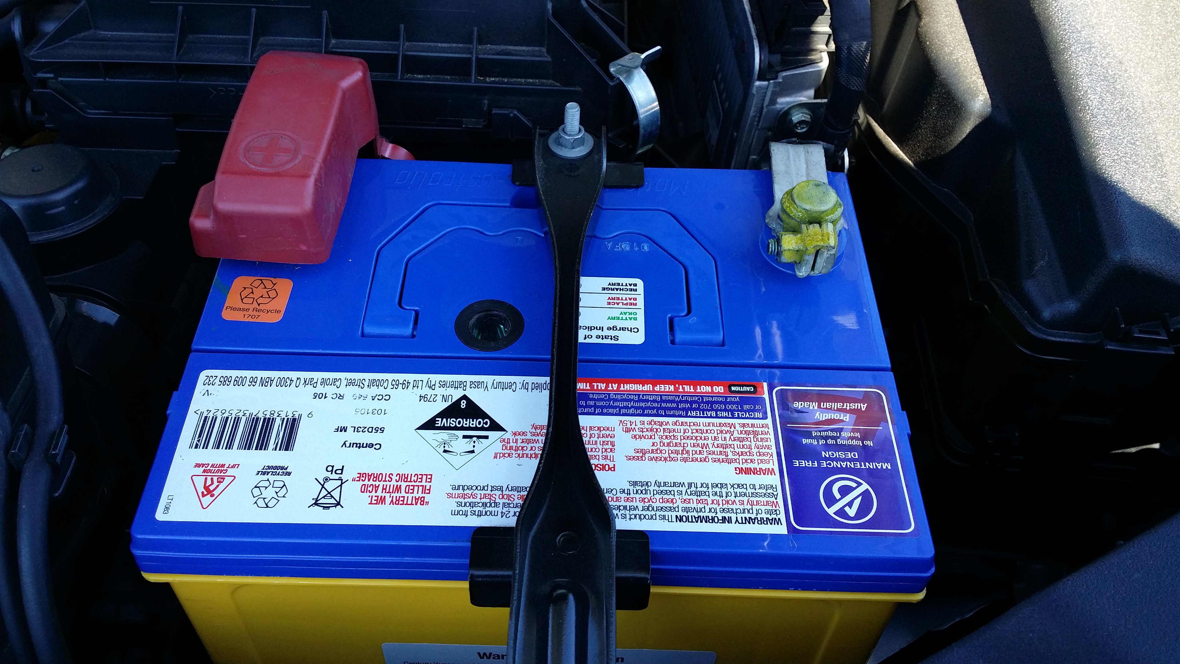

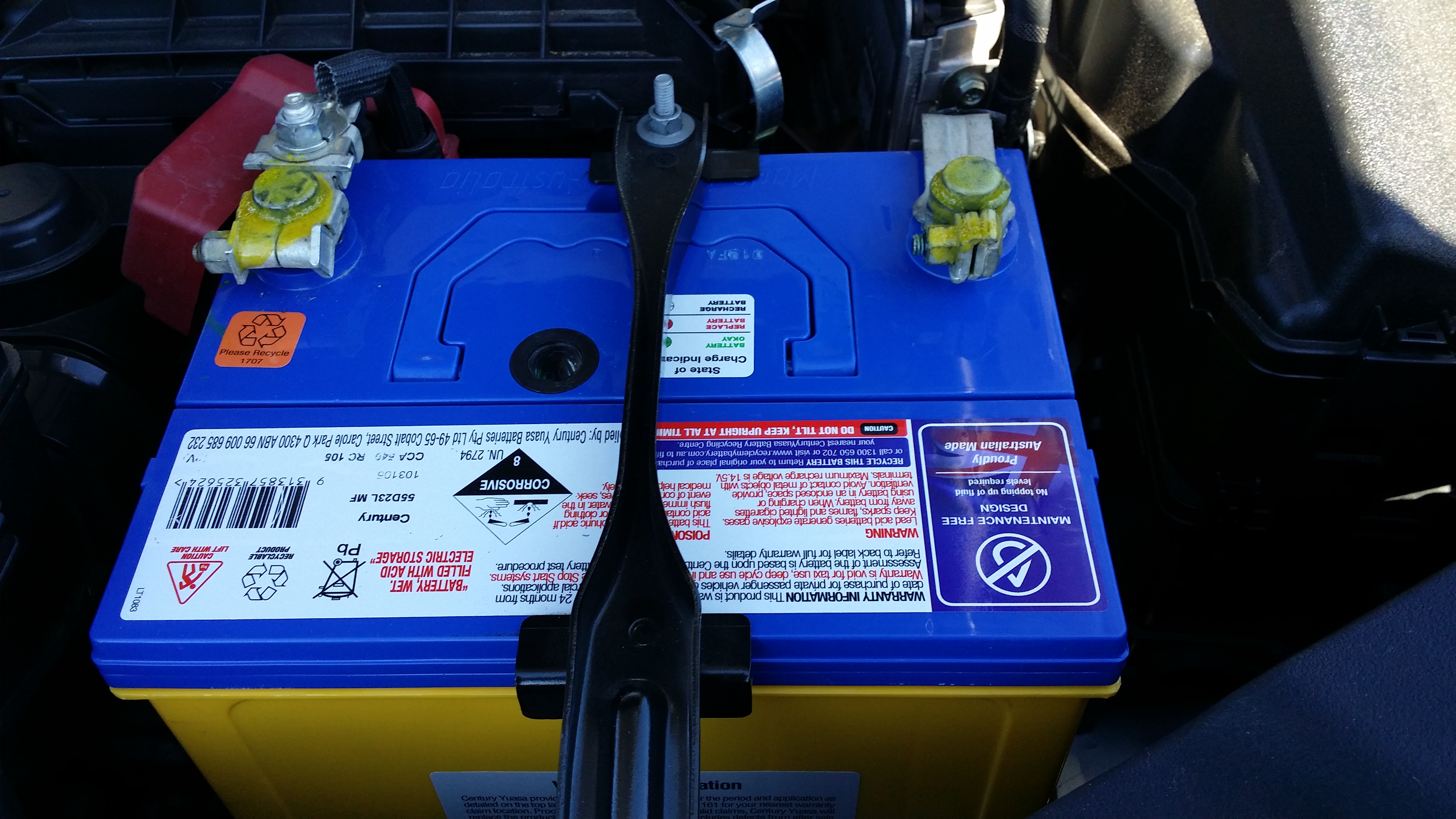

Thanks for all the comments guys.
Got the battery. Got an excellent deal too.
Cleaned and prepped the clamps. Sprayed some terminal protection too. Happy days !

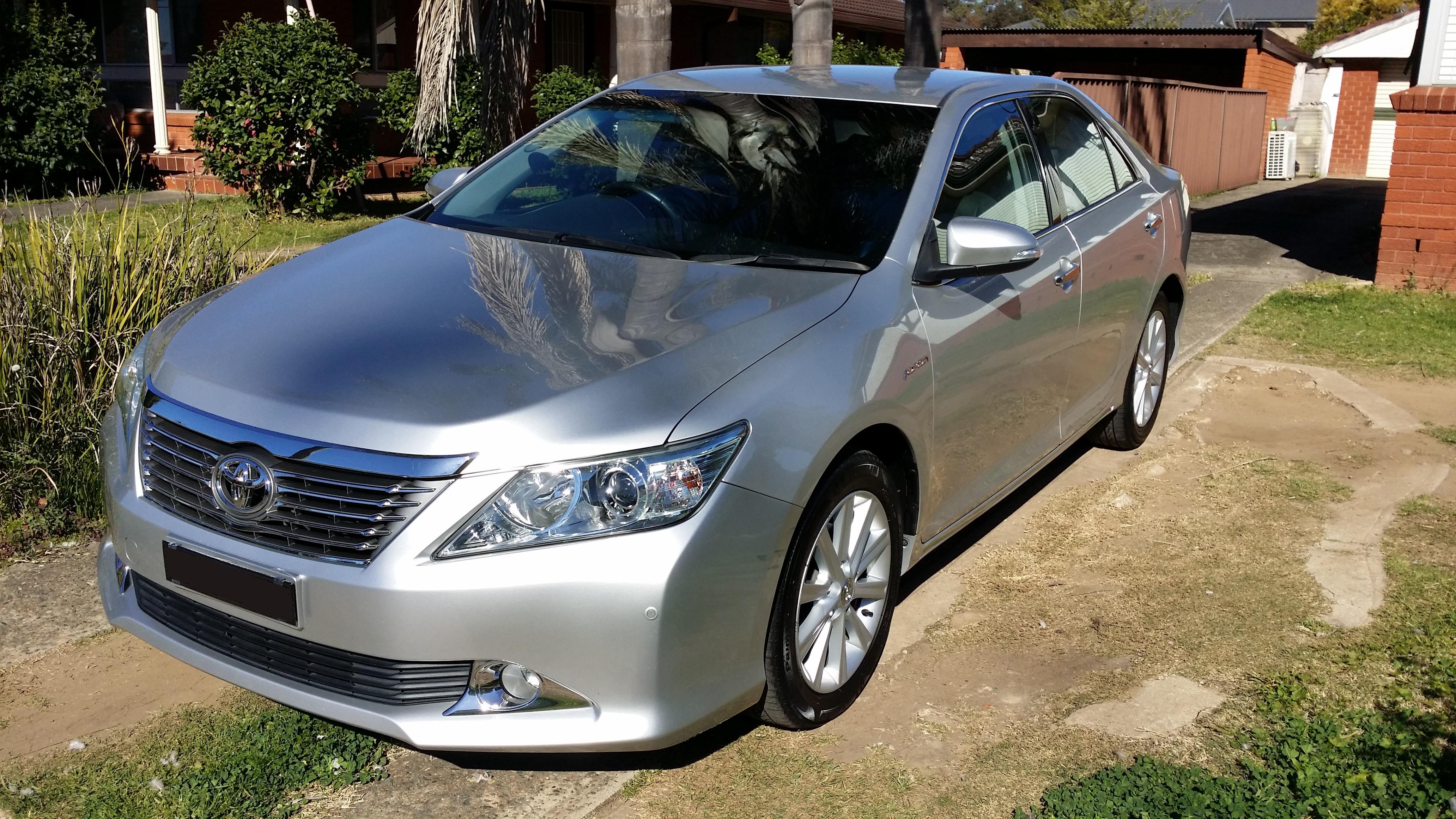

That Aurion looks like a brand spanka - how many clicks ? Nice ;)
Thanks for the kind words mate.
Its done almost 80k. I try and keep it as best I can.
