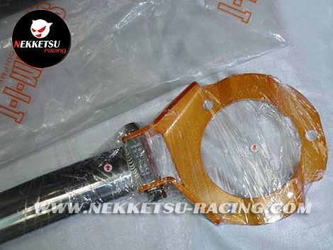

There aren't too many out there that fit the Gen 6 Camry. Out of the ones that fit, you make your selection based on stiffness. This can vary depending on the material used and the thickness.
I know of 4 (so far)
Summit (http://www.nekketsu-racing.com/www/img/Camry08-stb-summit-l.jpg)
Alutec (http://www.camryclub.com/modules.php?name=Forums&file=download&id=10022)
Ultra Racing (ofcourse) (http://www.camryclub.com/modules.php?name=Forums&file=download&id=20707)
no name (http://www.camryclub.com/modules.php?name=Forums&file=download&id=15176)
