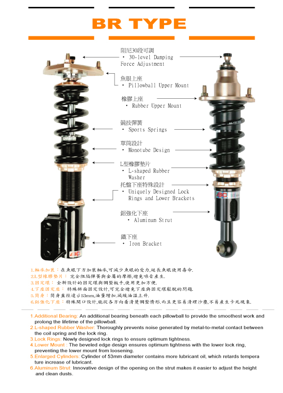

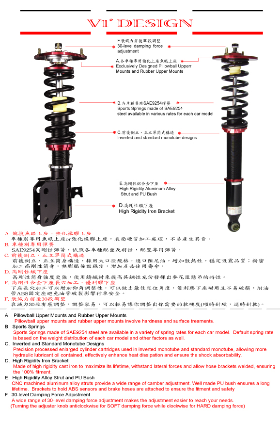

Went there yesterday and the V1 he can do $1100. The BR is couple of hundred more but are bit better and stronger but iam not too sure the diff,thicker tube,better lockiing rings etc.. Waiting to find out about ZRE's first..

Yeah Peter iam not sure of difference either but they all have 12 month warranty.. The guy in NZ only has BR now including both ZZE and ZRE and has given best price,JJap have V series but if he can do BR at better price then that could be the go me thinks.
Bit of info on the BR
http://cgi.ebay.com.au/ws/eBayISAPI.dll?Vi...e=STRK:MEWAX:IT
I was going to get superlows so might as well buy these cos i'll end up needing shocks anyway later down the track, this is perfect for my needs.

hmm so V series is "apparently" better? haha, i guess we just got to wait and see about the prices.. :)
