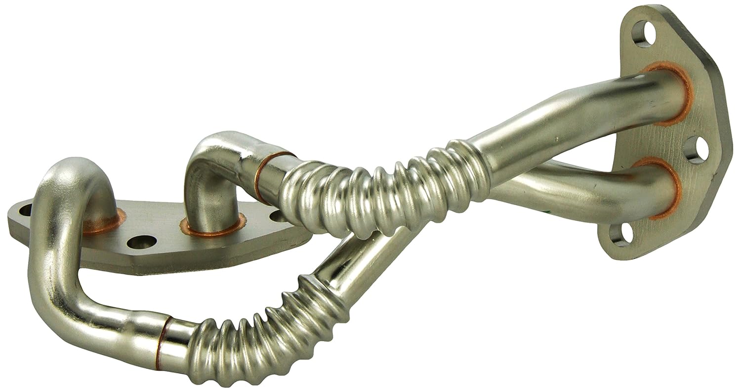

Can anyone point me too in the AURION MANUAL DVD of which heading to look at the breakdown of the actual "Oil Cooler" lines as I look under "Lubrication" and it not there.
Or could someone list the part for metal oil cooler replace lines and gasket in number of quantity required, as it is a vague at what to get?
As I can see there 2 metal oil cooler lines and there would be 4 gasket or I'm not seeing it wrong?
I would appreciate your help thanks, as this way I can order all the parts at once, via Amayama

Full Throttle posted all the part numbers including gaskets on page 1 of this thread in two separate posts.

Does not make sense, as I say there 2 metal oil pipes, can someone else please answer.

I'm not sure how it does not make sense to you.
This pipe replaces the two separate end flanges and the rubber hose for the oil cooler. The gasket part numbers are also located on page 1.
15767-31020, is the part below:

After many internet searches and looking at braided oil hoses on eBay, I will definitely be ordering the oil cooler part and gaskets from Amayama to fit when I do my next oil change in a few months.

I will also be ordering the top vvti all metal pipe and gaskets. Toyota have just quoted me $256.25 to replace it with the new improved rubber version, don't think so. All metal route for me. Don't know how they can get away with replacing it with the rubber version. They should make it mandatory that all pipes are the full metal type.

Thanks as I now can see it is 1 part and not 2?
