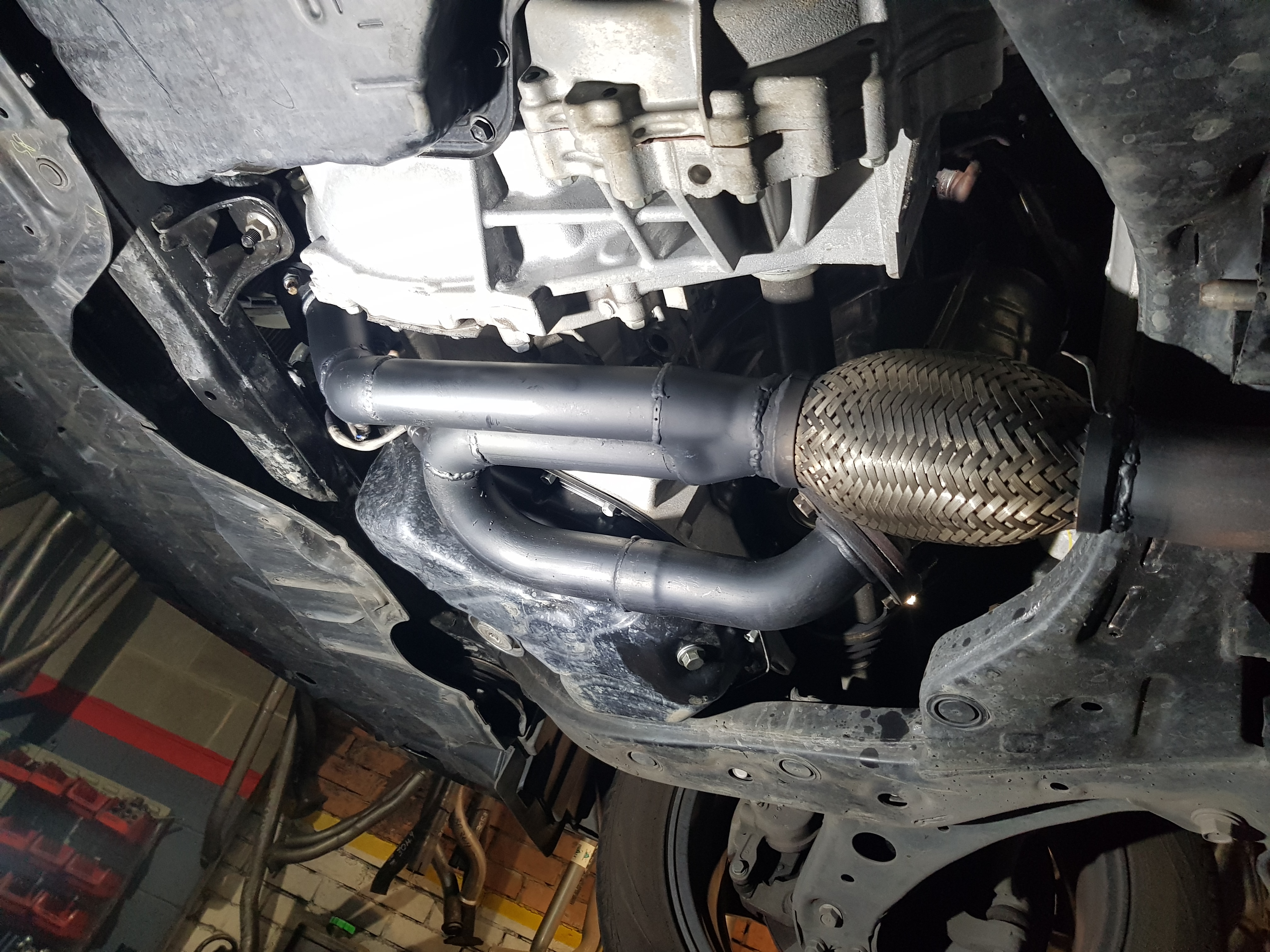

Aurion fi 4 Posted August 24, 2018 Report Share Posted August 24, 2018 I bought my aurion in 2015 brand new. Been a top car. I wanted a little more performance out of it. I have a K&N filter and also just did the exhaust collector mod. The standard pipe squishes together and very restrictive right where you want it to flow. We moved the flex pipe further back and had two pipes into a larger collector Professional workshop did it and its a top quality job. Car goes a fair bit better. 1st gear it just spins the tyres (235 tyres on 17 inch wheels). Massive axle tramp. Its definately making more torque and power. It just feels more urgent, like your driving downhill all the time. Might even get fuel efficiency gains Best thing is it sounds completely stock. I will try attach pictures. 4 Quote Link to post Share on other sites

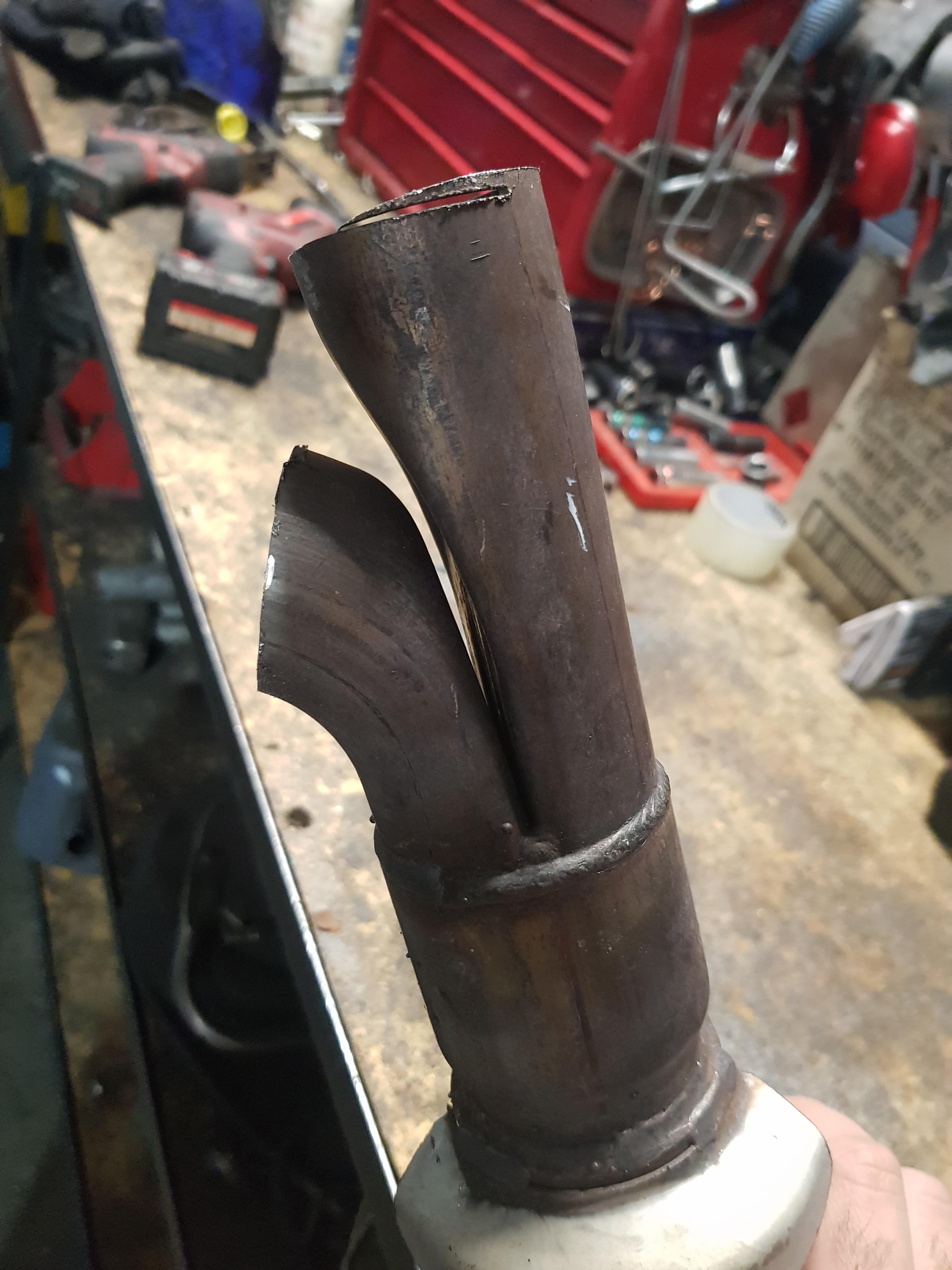

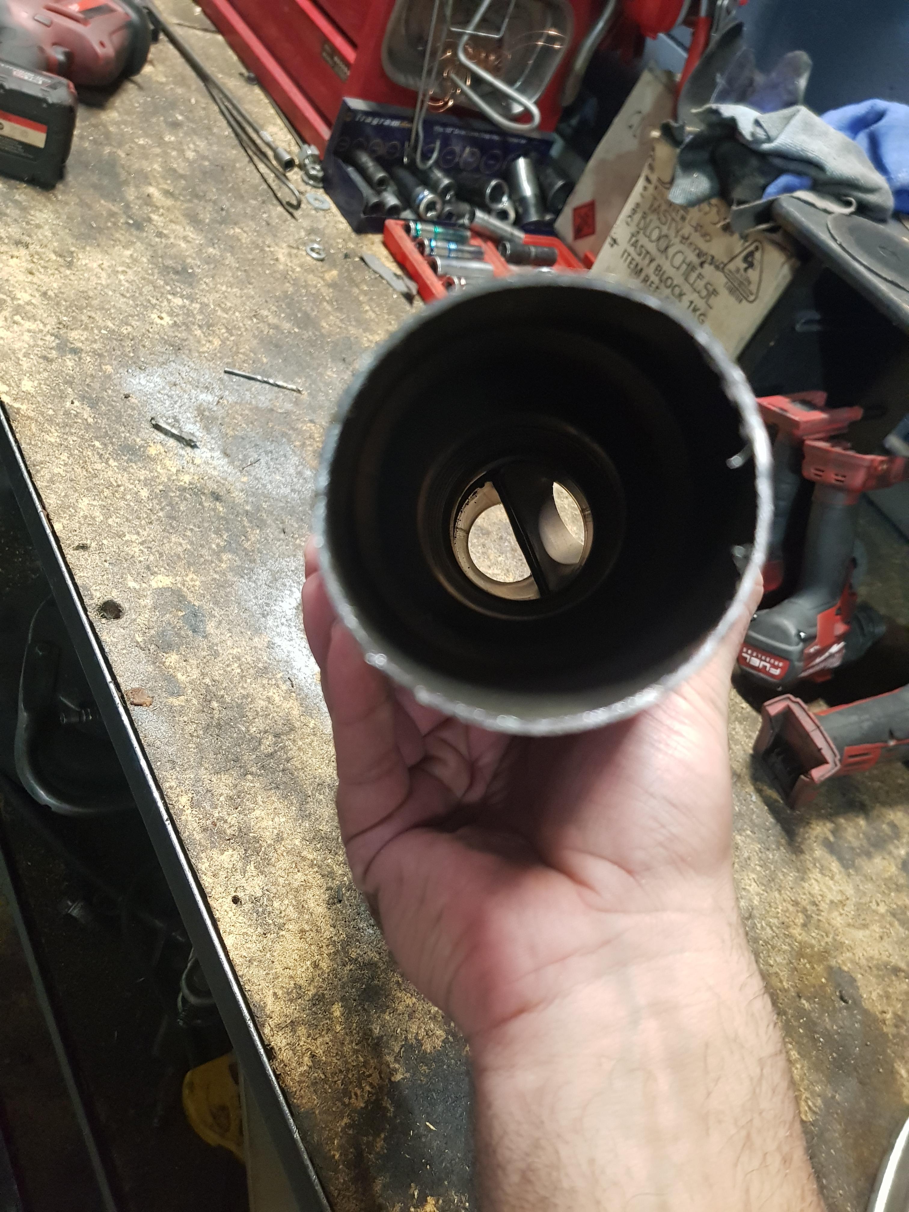

Aurion fi 4 Posted August 24, 2018 Author Report Share Posted August 24, 2018 Standard pipe below.. It basically squishes into half sized pipe. Right up under engine. Has to restrict performance. Quote Link to post Share on other sites
campbeam 557 Posted August 24, 2018 Report Share Posted August 24, 2018 1 hour ago, Aurion fi said: We moved the flex pipe further back and had two pipes into a larger collector Professional workshop did it and its a top quality job. Looks like a worthwhile modification. How much did this cost and how long did it take for the shop to do it? Quote Link to post Share on other sites
Aurion fi 4 Posted August 24, 2018 Author Report Share Posted August 24, 2018 Took 2 hours to do and $250. I suspect ill make it back on fuel economy. It sounds absolutely standard. It seriously breaks traction so easily. Just cruising needs barely any throttle to get up to speed, feels more effortless. Aurions are not slow to start with but this mod definately turns it up a notch. Quote Link to post Share on other sites
campbeam 557 Posted August 24, 2018 Report Share Posted August 24, 2018 1 hour ago, Aurion fi said: Took 2 hours to do and $250. Thank you for your contribution to the Forum. Good solution to move the flex pipe back to gain the extra needed space. The modification is very tempting at that price and worth further consideration. Quote Link to post Share on other sites
Aurion fi 4 Posted August 24, 2018 Author Report Share Posted August 24, 2018 (edited) They considered removing flex pipe altogether but i wanted it in. Moving it back was a great resolve. Ill report back if i get more km to a tank. No sound change at all. Its quiet. No engine check lights or anything negative. Part throttle response is fantastic. Only downside i see is in first gear, need to feather the throttle on a fast takeoff, Needs better tyres now. Edited August 24, 2018 by Aurion fi Quote Link to post Share on other sites

Aurion fi 4 Posted August 25, 2018 Author Report Share Posted August 25, 2018 (edited) Not a friends price. First time i walked into exhaust shop. Pm me and I will provide shops details. The negative is you simply cannot floor the throttle from a standing start. It gets axle tramp badly. Need to feather throttle. Go about half throttle and from about 30km/h then floor it. Will still turn the tyres. It wasnt like this standard. So i suspect my car is now making more torque? I need better tyres now I suspect toyota squashed the pipe to limit the low end torque?? Edited August 25, 2018 by Aurion fi Quote Link to post Share on other sites

Aurion fi 4 Posted September 1, 2018 Author Report Share Posted September 1, 2018 (edited) Yeah read that thread before but no real outcome / conclusion was stated? Mine is definately going better than standard. I think its not just the bigger collector that removes the squashed pipe restriction but also moving the join of pipes further back helps. Gasses cool as they progress from engine back through the exhaust, the dual pipes merge further back and into a less restrictive collector. Unfortunately I have not dyno tested the before and after gains but posted videos to evidence it goes pretty good and sounds completely stock. Edited September 1, 2018 by Aurion fi Quote Link to post Share on other sites

Aurion fi 4 Posted September 15, 2018 Author Report Share Posted September 15, 2018 UpDATE I also have a 3.0 v6 camry. I checked it underneath. It dont have the squished pipe. It has a nice flowing merge. Im wondering why toyota intentionally had it squished up for aurion. Quote Link to post Share on other sites
