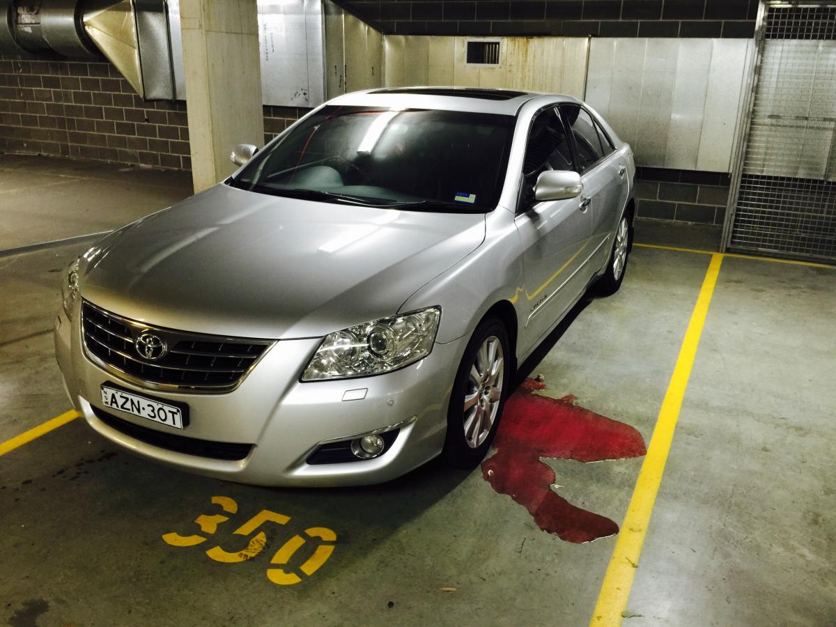

I woke up this morning to a pool of coolant this morning, there was no signs of any leaks in the past.
Got it towed to my mechanic and his told me its the water pump.
How can a water pump just break without any notice?? Have anyone else experience similar problems as me ? is this a common fault for aurions?

I just wanted to say that I love John's photo, it has a good crime-scene look to it, who shot the Aurion?

Haha yes I too love this pic for the crime seen effect it has

On 22/12/2014 at 0:59 PM, John1982 said:
post-37238-0-90991500-1419213497_thumb.j
It's bleeding to death . . . . I've never seen a water pump do that.
